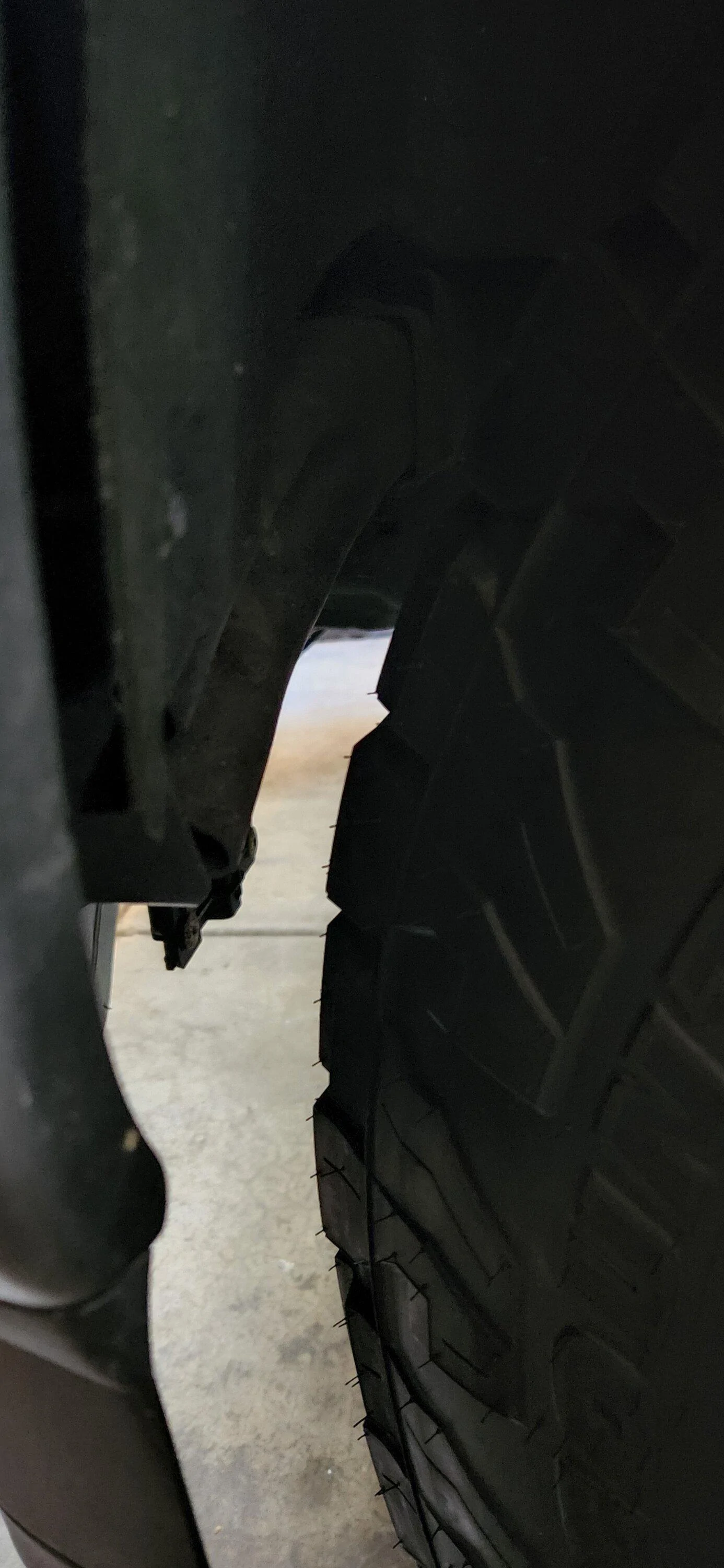

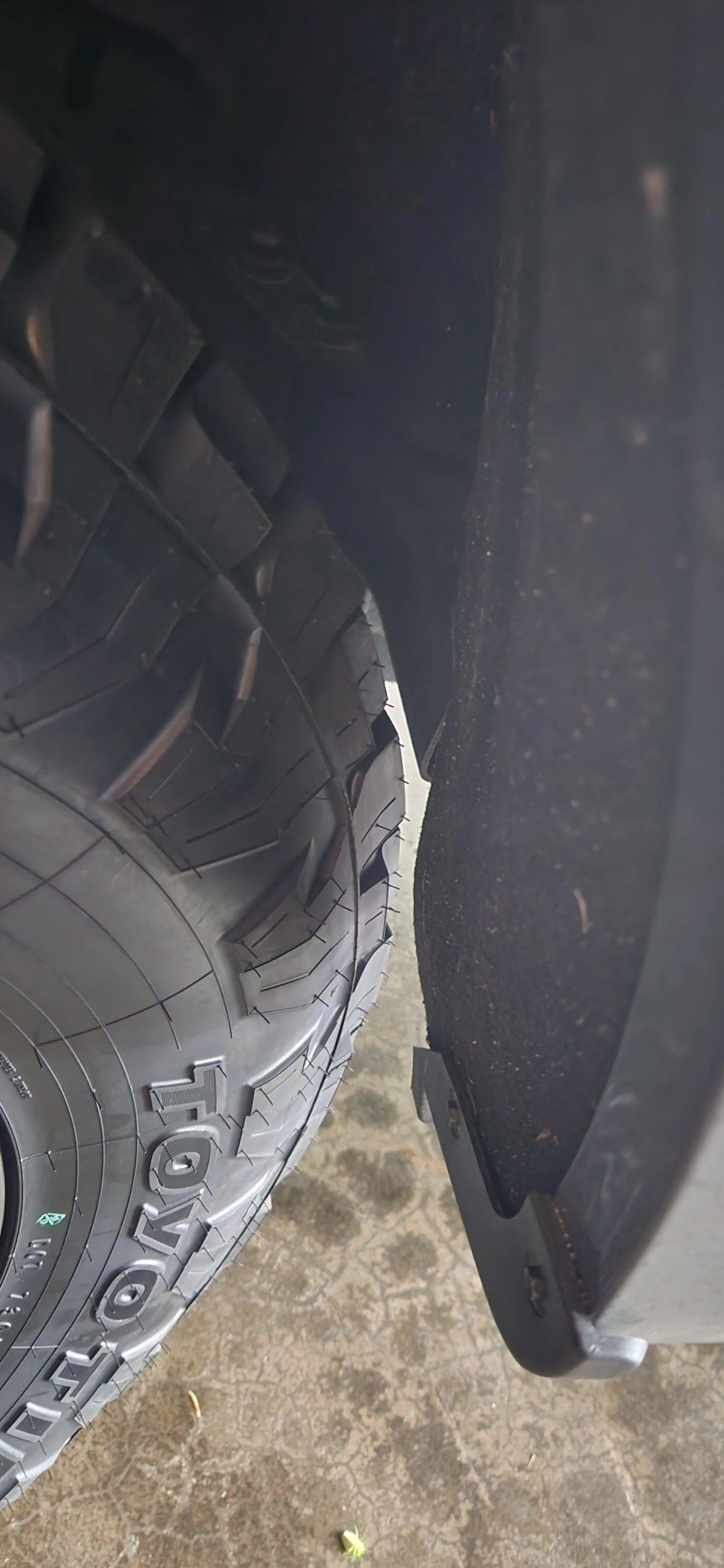

Im about to order new tire set in the next few days and wondering if 295/70/18 will fit with no issues. So far Im looking at Toyo open country AT3 and my new wheels are Black Rhino rapid 18/9 +12 truck is leveled on RC coilovers. Anyone running this size and offset without rubbing?
Toyos Spec sheet says they are 34.3 /11.8

So if anyone is interested this set up fits I only had to remove small fender trim piece in back as it was slightly rubbing on turns but only on the driver's side. I could definitely rise up my front coilovers as I still have about inch rake but didn't feel like messing with it it was easier to remove that plastic corner piece. Im very happy how it turned out I changed from 275/60/20 and before my front end was sitting just slightly over 40in
Ford F-150 Tire size question 20220822_073914
Ford F-150 Tire size question 20220821_120120
Ford F-150 Tire size question 20220821_120140
Ford F-150 Tire size question 20220821_162039
