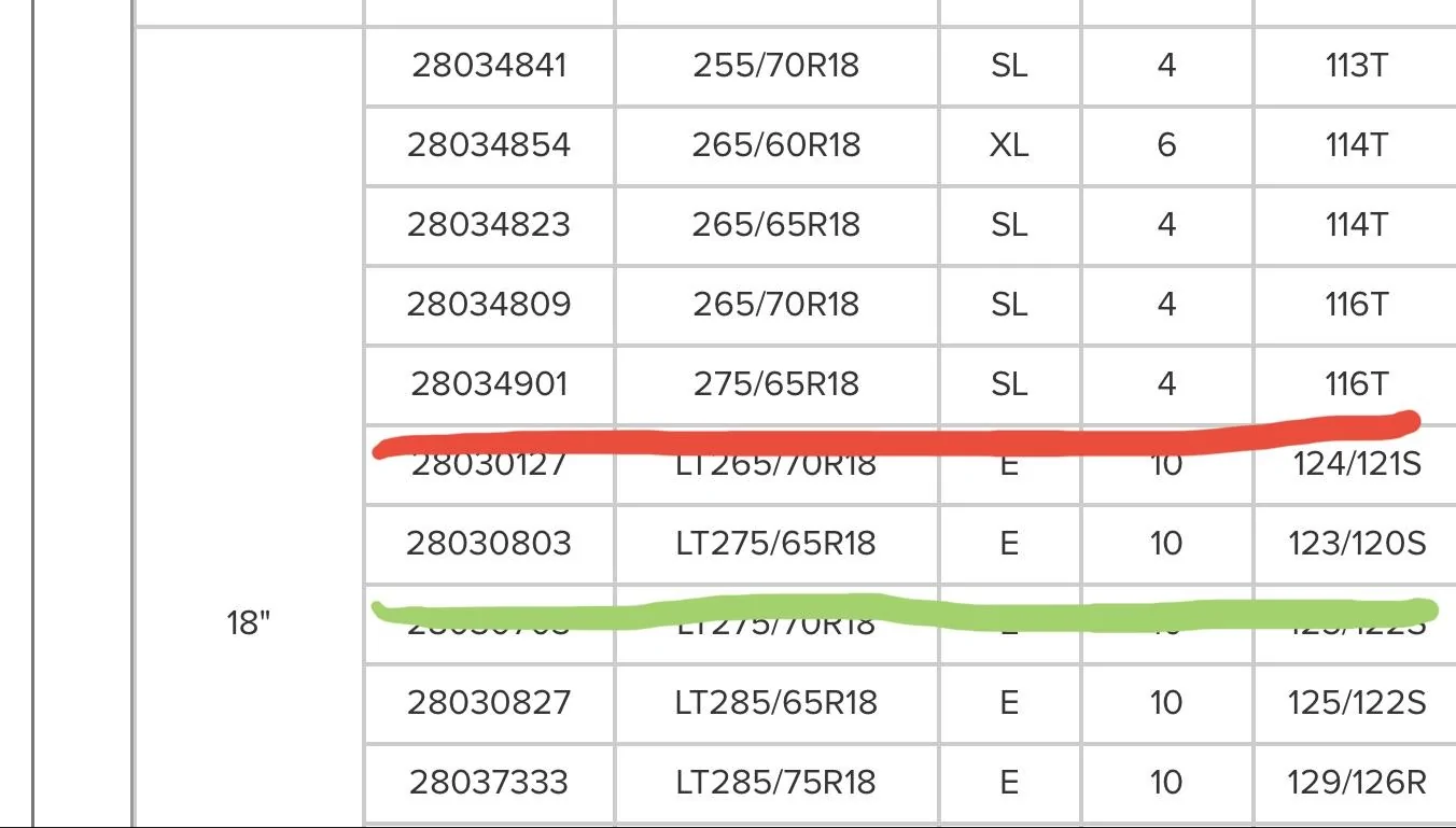

My Falken Wildpeak AT3W SL come with a 116T load index…
Ford F-150 HDPP 18" wheel/tire size question 6BB49D4F-428C-4C8E-81D0-91F3B8B6FB42

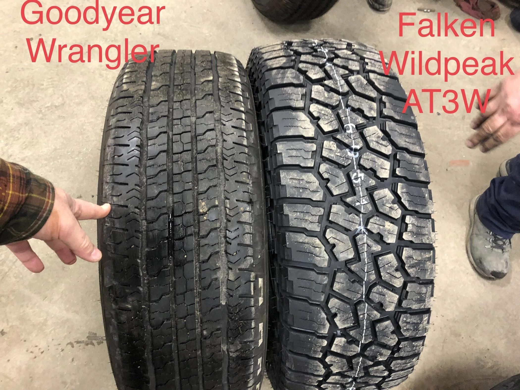

Put them on my 2020 XLT the day I came home.
Ford F-150 HDPP 18" wheel/tire size question F2B1D7F1-A3D4-4D82-828B-FCB676F8884F
probably cost me 1-1.4 mpg fuel economy too over the Fortitude HT that were on the truck.
Ford F-150 HDPP 18" wheel/tire size question EF9D81B2-365E-4EBC-BF61-990F0F2BAE4E

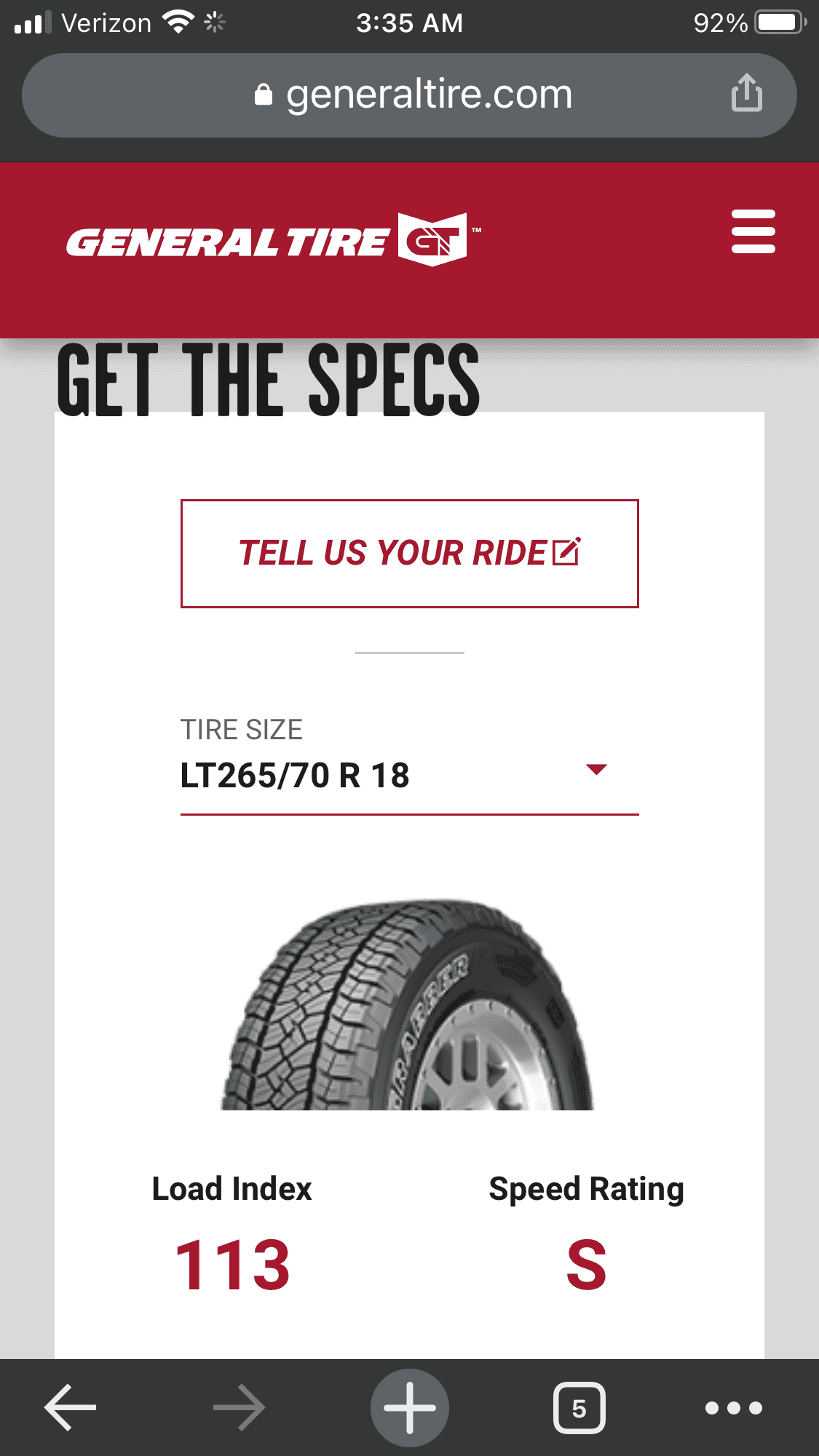

this is the LT tire Ford ships with the HDPP truck?
Ford F-150 HDPP 18" wheel/tire size question FEBD8D6D-CE13-4C4C-AAEB-EE80F8A93C0B
