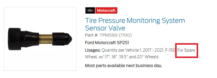

Does anyone know if the spare tire is also equipped with a TPMS sensor?
seems like there should be:
Ford F-150 Tire rotation and TPMS reset 1669302654220
