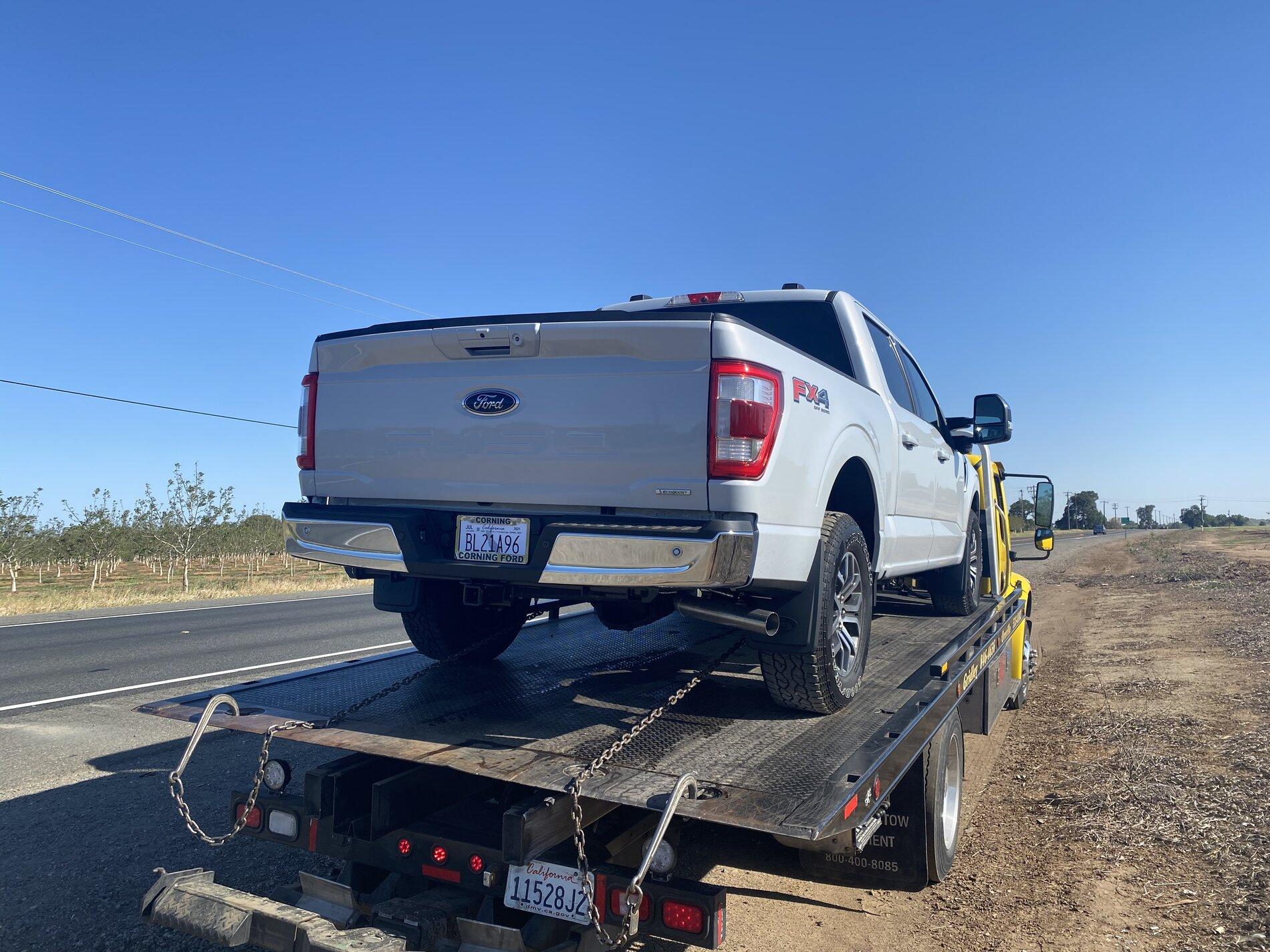

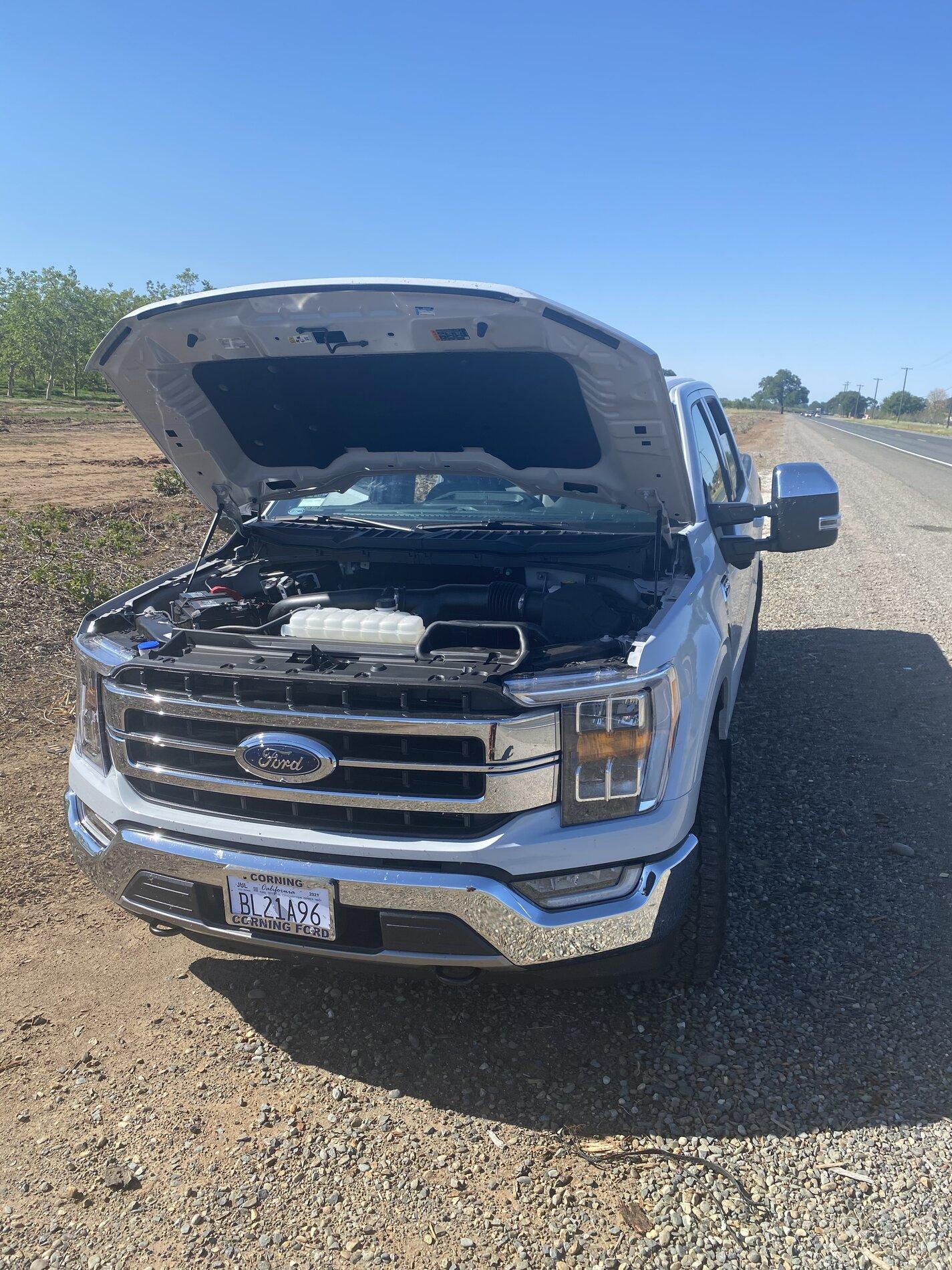

10 days and less than 700 miles in, and my truck overheated and spewed coolant everywhere from somewhere low in the engine bay. Here’s my Saturday evening...

So sorry to hear that man. Did it just happen out of nowhere??
Totally out of nowhere. The tow driver did say that he sees the least amount of Fords on his truck, vs all other brands, so that’s comforting. I’m relatively certain it’s a coolant clamp, but we’ll see! Not excited about it, but I’ll give Ford a chance to fix it.
On to the good stuff: I called my salesman, who called the service manager who called me and offered to pick me up. Neither were working today, and the service manager was at the dump with his daughter and was going to pick me up on his day off. Unreal. He mentioned that the 3.5 EB is very reliable and he thought it would be a diesel when he first got the call...

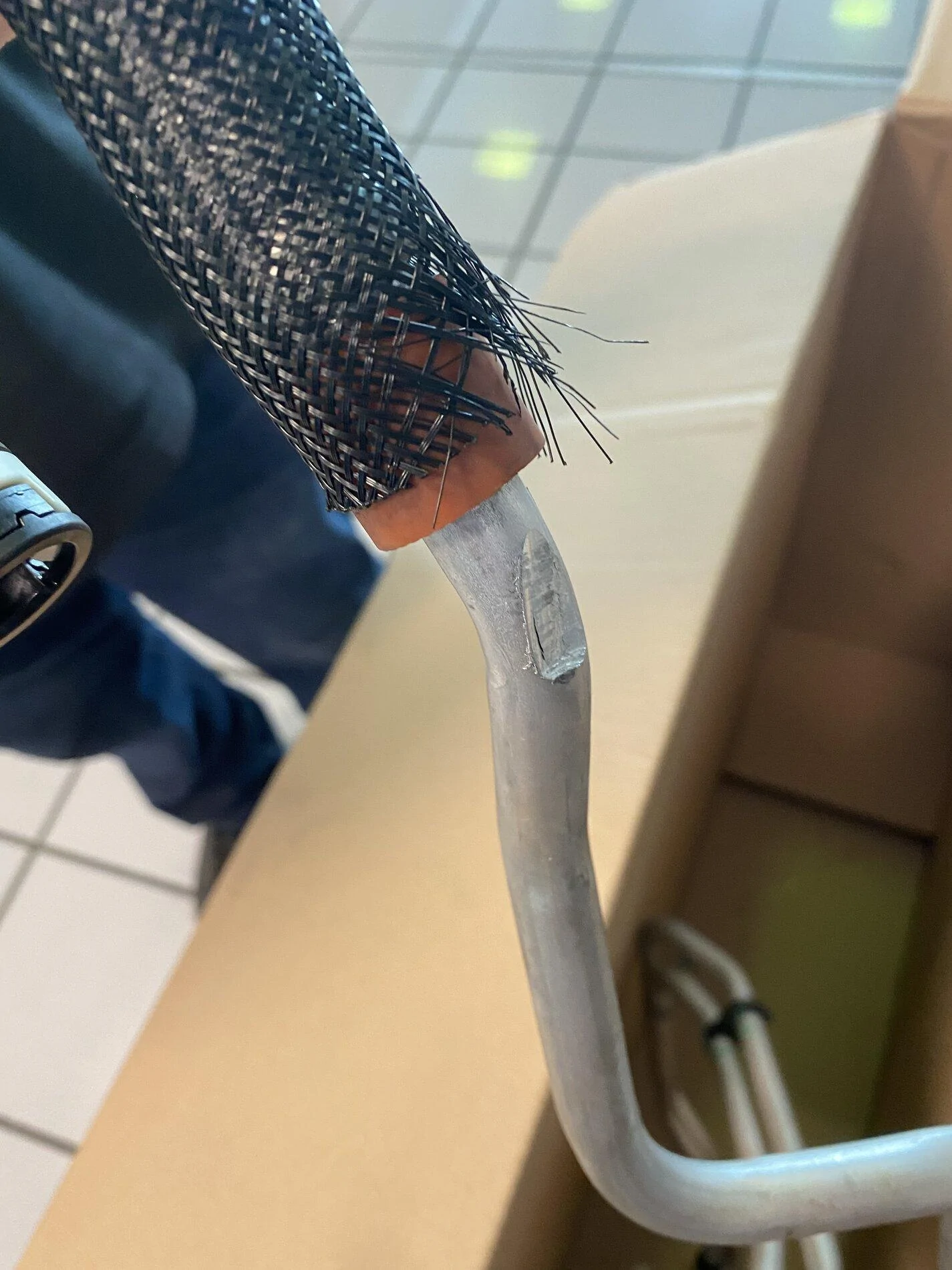

Turns out it was a coolant line to the transmission that was rubbed through by the front driveline. It’s a formed rubber coolant line, that was installed, for lack of a better term, upside down. Meaning the bends were in the wrong place which led to the issue... hopefully fixed by Friday. We’ll see!
WOW! Mistakes can happen for sure but something like this from the assembly line? WTH?

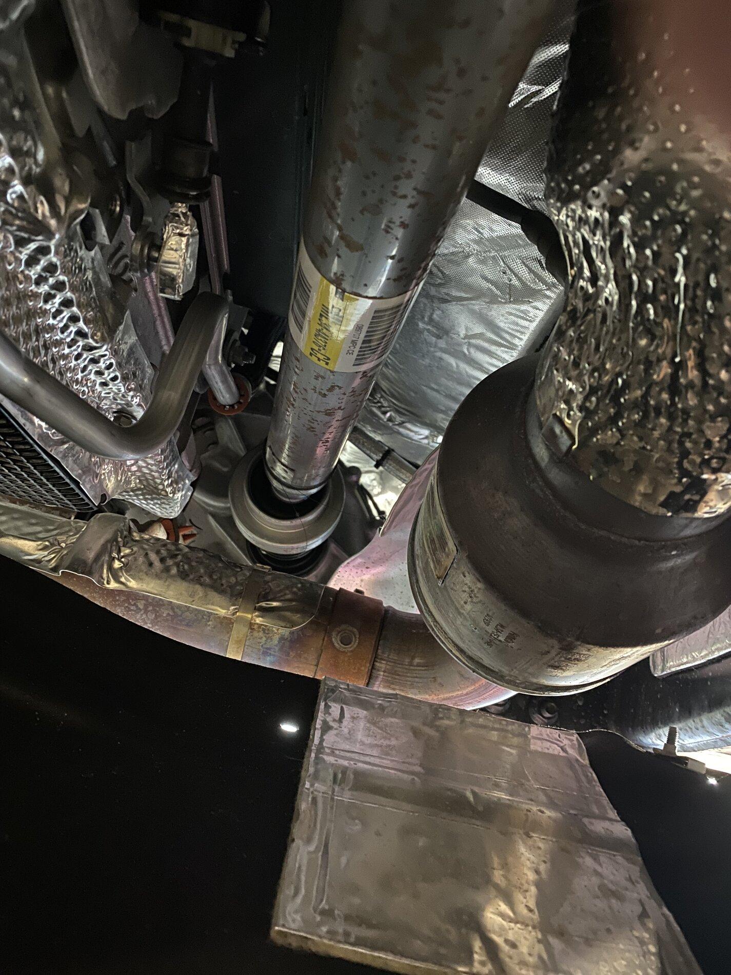

From the underside. I think the weight on the driveline is what smoked the hose.
