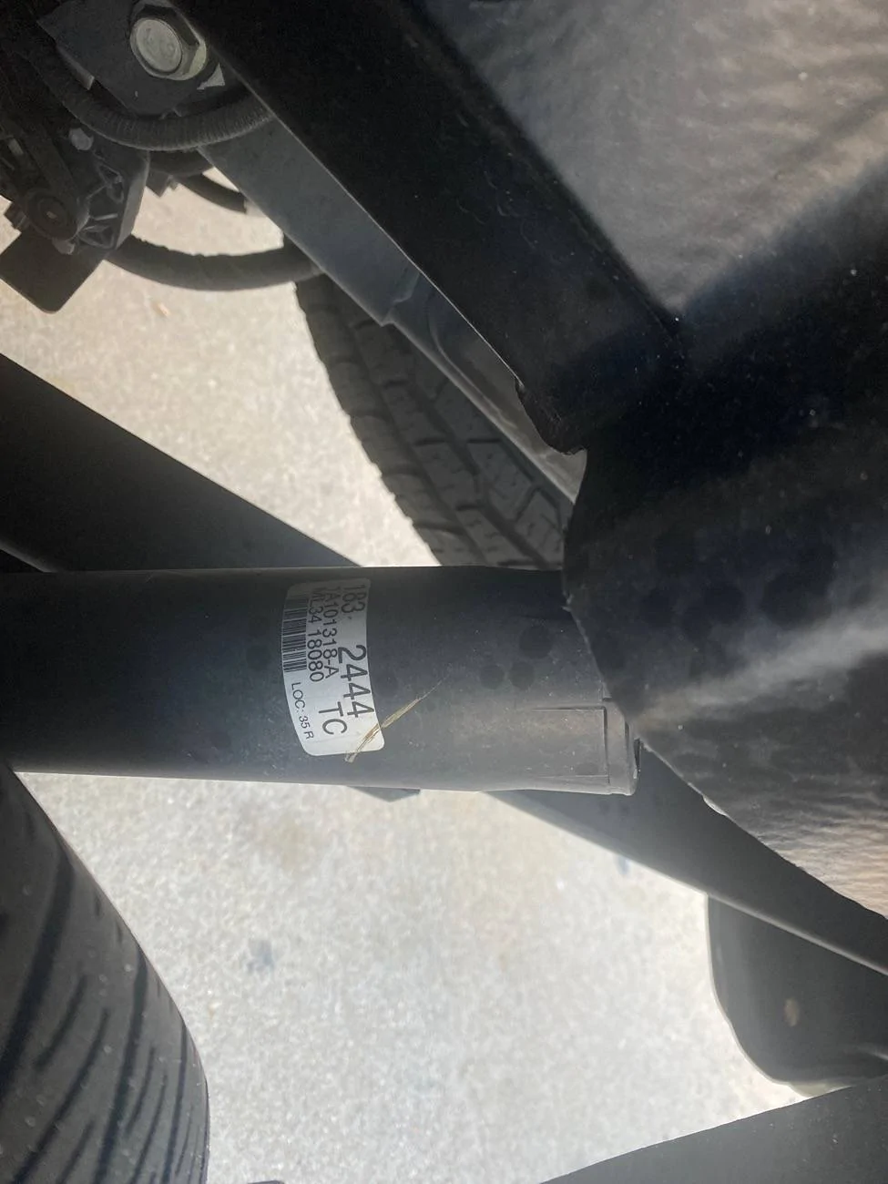

I bought a 21 with 25 k on it. It apparently has hd shocks. Heres my problem: when coming out of a turn, the truck rocks and roles. I need to be at a snails pace to limit this. Certainly not the ride we were expecting.
Never done anything suspension wise to any of my trucks in the past and i assume that the hd shocks has to do with the towing ability of the truck. The truck is stock with original Goodyears 275/60r 20 115T. I think the tires are dual ply tires?
So my goal is to just temper the ride to what would be a normal ride for a F150. Thoughts?

Your Platinum probably has the Ford CCD system, or Continuously Controlled Damping, and not regular shocks.

Do you have the CCD shocks?

You do not have CCD. A CCD shock would look similar to this:
Ford F-150 Taming my 21 platinum - ride IMG_6636

What don’t you like about the ride? What type of ride are you looking for? Rear shocks are cheap and easy to do. Without knowing what you’re after it’s hard to give an idea for you to try. Body roll a sway bar will help a lot.

I don’t want to feel like I am in a boat when I turn. Rock and Roll! I love the truck other than this and I know it’s something simple, that’s why I am asking. Have zero experience with troubleshooting suspension.
