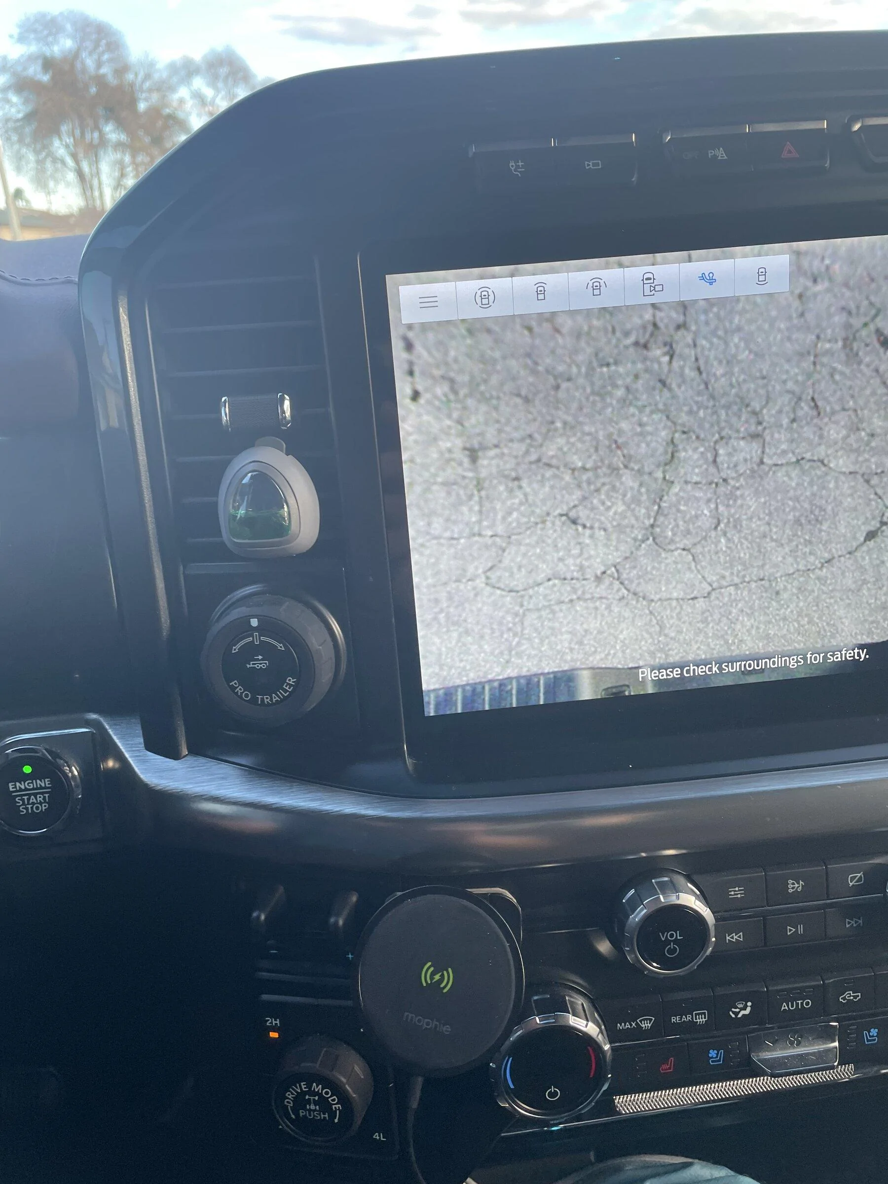

I've not seen it on my side screen also. But I have a different question on the same thread. Does anyone know how to get rid of or change location of the rear view "Check Surroundings For Safety" message? Its taking up prime real estate in that view. Frustrating.
How did you get full screen of the rear view?. I can’t get this view when I’m driving. When I’m stopped, I see the button for the rear camera but when I press it. Nothing happens.
Jabrego, not sure what dictates the view you get. I’m still trying to figure that out. I simply added the “Camera while in motion” function through FORScan and I get the tailgate, hitch, and bed views available while at any speed. The hitch view is kinda pointless ?‍♂. Bed view is handy, but the tailgate view is the most useful and it’s got the dang warning right in the prime spot. ?

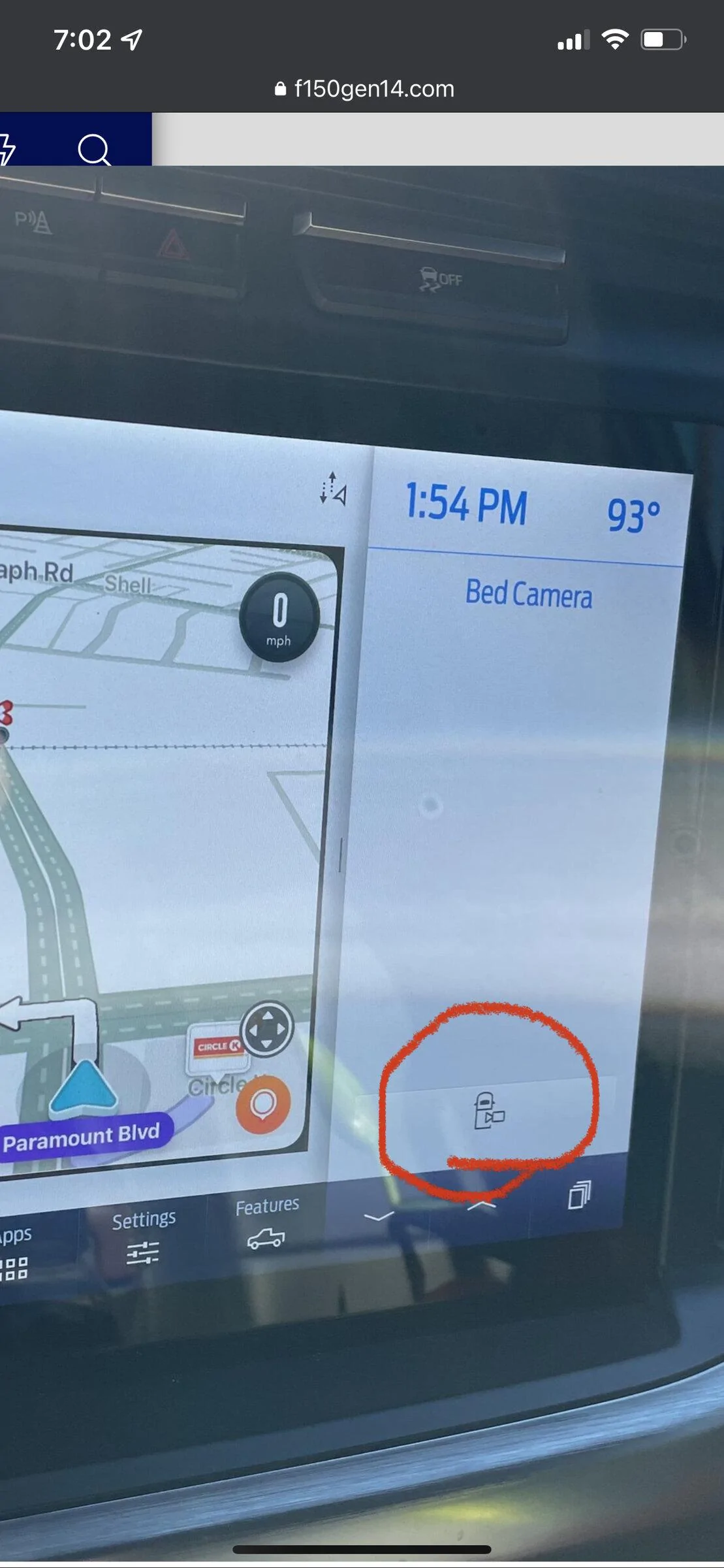

Did you try pressing the camera button again on the side card?
Mine works but I have to press that bottom button (Circled in red). Also, try it when not connected to car play…just for experimentation.
See video I added. You will notice that I can’t access the rear view camera while driving. Not only when I’m with double screens but also when the hitch is on full screen, I can’t switch to rear view. Can you tell me what steps you take to get into full screen rear view?

When you press the hard camera button once, What soft button camera view options do you have? I noticed in the Video you hit the hard camera button twice before trying the soft buttons.
have the same buttons as when I have double screen. See photo below. And the rear view soft button doesn’t do anything
Just a thought... There is a setting in @livinitup's ForScan spreadsheet under the APIM titled "Driver Restriction Images" (7D0-01-02). If you're brave enough to play around with it, I wonder if that could be referencing the safety disclaimer shown(?)
