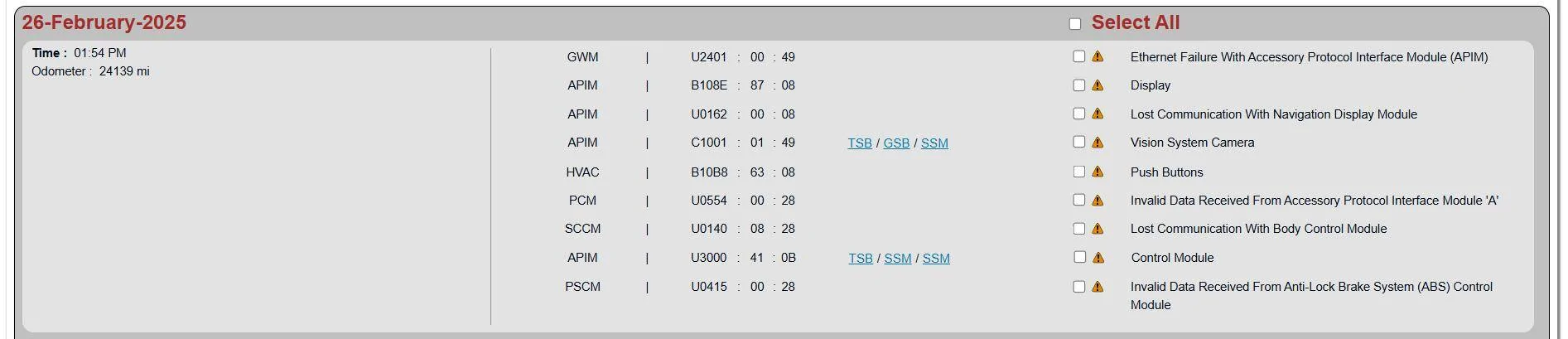

Well, the seller sold you an APIM on broken software from 2020 known to break the OTA process and is incompatible with the software the other modules your truck is on which is why certain things are not working. These Sync 4 vehicles are very sensitive to the parts you put into it. P/N and software need to match exactly for it to work. It is not as simple as copying the config from your old APIM onto the new one.
If the dealer connects your truck to FDRS and sync it up the server (or your trucks syncs itself to the server), it will most likely makes things worse as there will be mismatching data on the server and this will cause even more issues down the line.
I do not have the knowledge to tell you how to properly do what you want to do and the one person on here I know that does cannot help you due to a conflict of interest with his employer that sells kits to do exactly what you did. You cannot program the APIM yourself with FORScan and the dealer for sure cannot do it with FDRS. The second they do a network scan and that data goes up to the mothership, it will make things worse. Your truck is reporting several codes on the APIM calling out the incompatibility of the APIM you put in with your truck.
Ford F-150 Sync 4 update issue-installed new (used APIM) 1740600222051-sc
The good news is, the APIM you put in has not made it's way up to the mothership yet because I still see what I assume is the old serial number in there.
Ford F-150 Sync 4 update issue-installed new (used APIM) 1740600290394-13
If I were you, I would unplug the TCU before it does sync up and contact a reputable company like Infotainment about doing this the right way.
