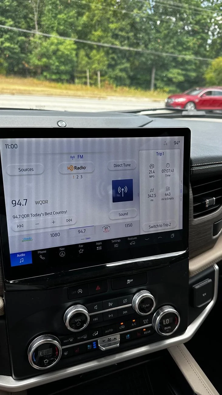

Drove a newer 2024 Expedition today, noticed it had the option for the 1/4 screen on the right side of the main screen to have the Trip info displayed. My 2021 F150 has the larger screen with Sync 4 however I can't find that same screen option? Can it be updated to show this? This would be very helpful.

The trip screen was standard on my 21 XLT. Use the arrows right below the right hand screen to scroll through the different screens.

Follow directions above. I keep the trip card up all the time on mine too. Nothing else is useful to put there for me. Maybe bed camera if I was hauling something.

Trip info can be enabled/disabled via Forscan. I have mine off for Trip 1/2. I would put up "This Trip" over there but that doesn't seem to be an option.
Check out the Forscan spreadsheet APIM 7D0-01-03 area
