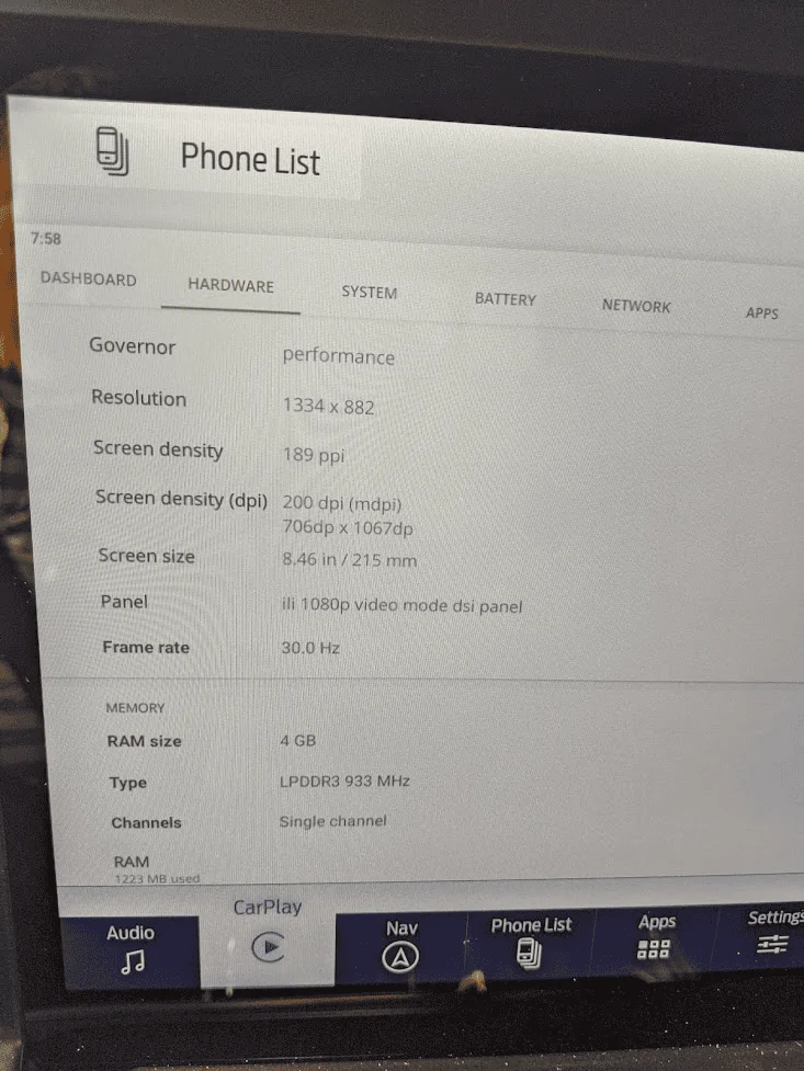

Does anyone know what the technical specs are for the sync 4 screens? I am working on a project related to Android Auto and I can't seem to figure out what resolution and DPI the Sync 4 12in screen is.
From this image (capture through one of those CarPlay AI boxes) it appears the resolution allocated for the Android Auto and CarPlay is 1334x882. To me that doesn't make since since Android auto only allows for 800x480, 1280x720 and 1920x1080 resolutions. I did a screen capture through developer settings and I found that the screenshot is also 1334x882. Any thoughts?
Ford F-150 Sync 4 screen technical specs 1643823431628

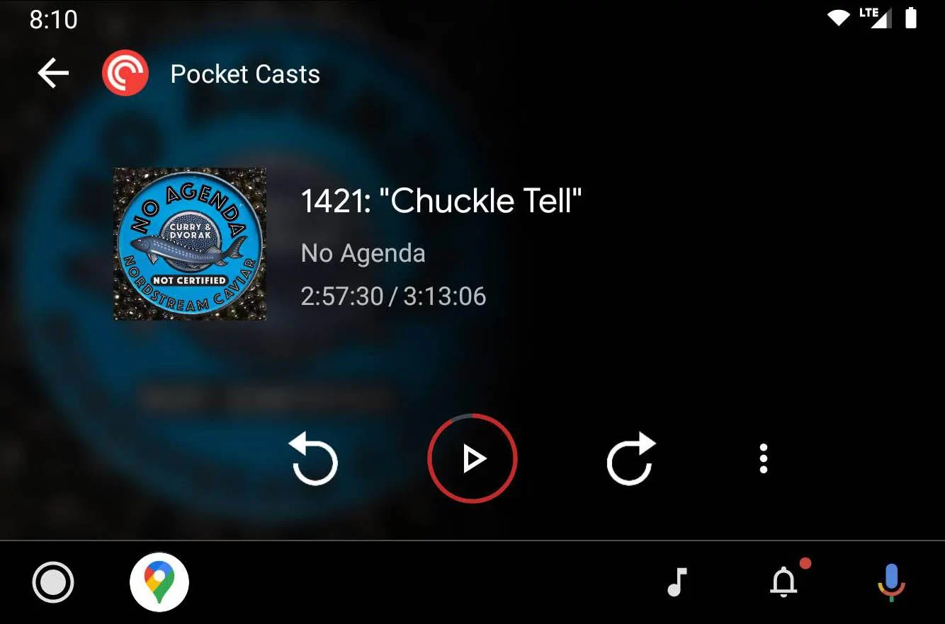

This image is 1334x882 also.
Ford F-150 Sync 4 screen technical specs 1643823602780
