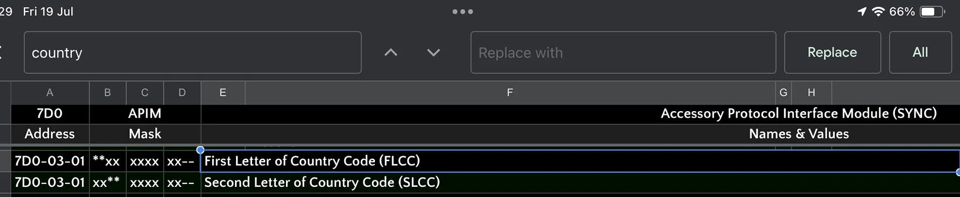

@AbdAlrahman9989, In the APIM, change first letter to 55, second letter to 53. That's for country code "US"; start with that as not all country codes are recognised by the APIM.

In addition to that, change the country code in the TCU to see if the modem will work.
