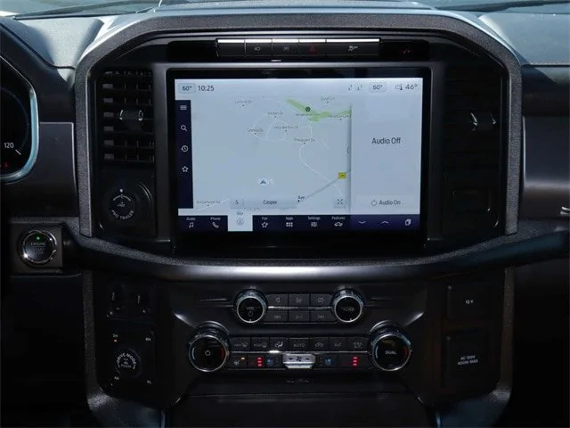

I've tried looking through Forscan but I can't seem to find out how to get the temperature readout on the top bar of the infotainment screen. Is this located in APIM?

Using Forscan, Search for word "bar" in APIM module (Not As Built).
Then enable Status bar temperature, reboot apim module.

This is already enabled in Forscan. Would it have to be in As Built?
