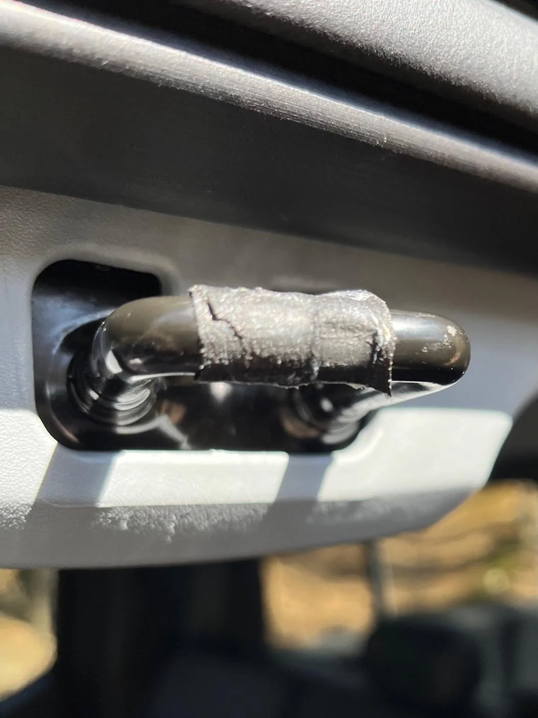

I brought my truck to a different dealer. Service guy said that rattles aren't covered under warranty ... but next time I had it in for service or an oil change, they'd take a look at the noise as a goodwill gesture. He said it's tricky to adjust door alignments and could wind up creating a different noise (like windnoise). But he mentioned something useful! He said to try using some friction tape around the latch. When I got home, I added the friction tape and NOW THE NOISE IS GONE. Check out the photo.
-Nighthawk -- sounds similar to what you did?
Anyway, if any of you with supercabs are having noise issues, give this a shot.
