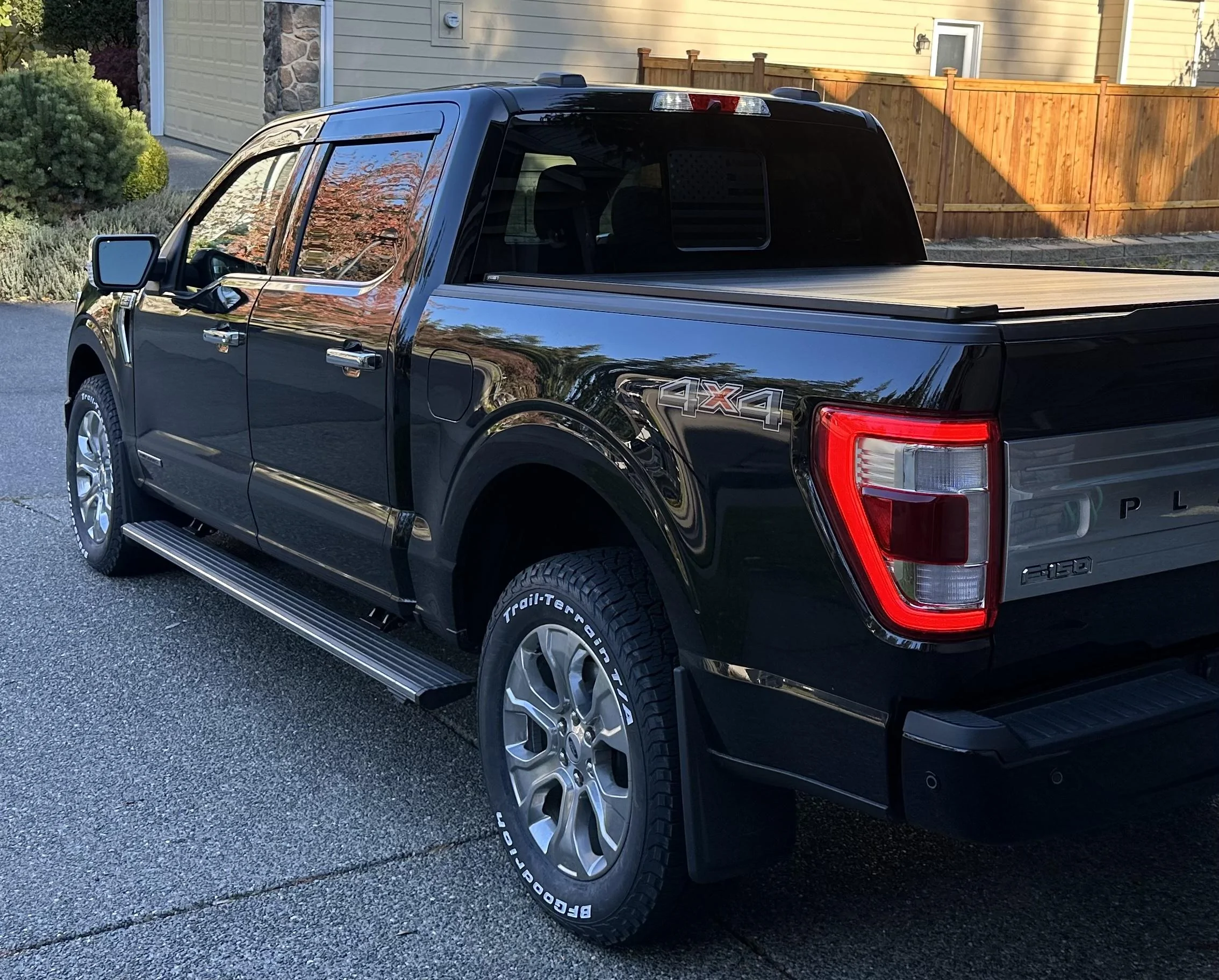

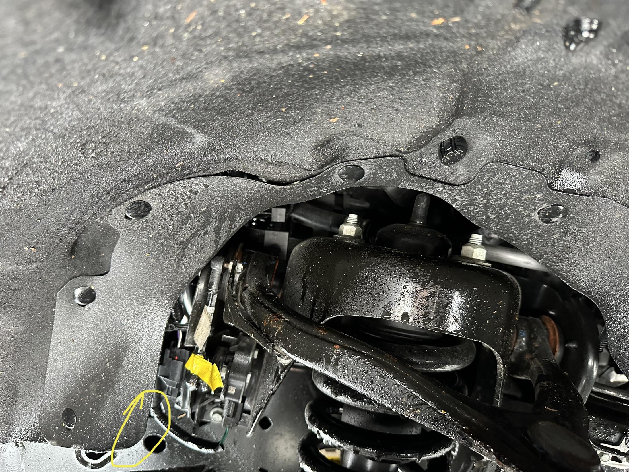

Hi everyone,
I've replaced my Platinum factory tires (Hankook) with the same size, 275/60/20 BFGoodrich Trail-Terrain T/A. They look very well, no extra noise, similar millage but the weird thing is rubbing when taking max turns. There is this flimsy protection on the upper inside part that is touching, especially when the tire moves in reverse.
I suspect the tires are slightly wider, anyone experiencing something similar or what to do ?
That cover seems very easy cut with some scissors about 1 inch or even push it a bit more inwards, it just returns after a while (looks lole some carton or soft material mud protector).
Thanks

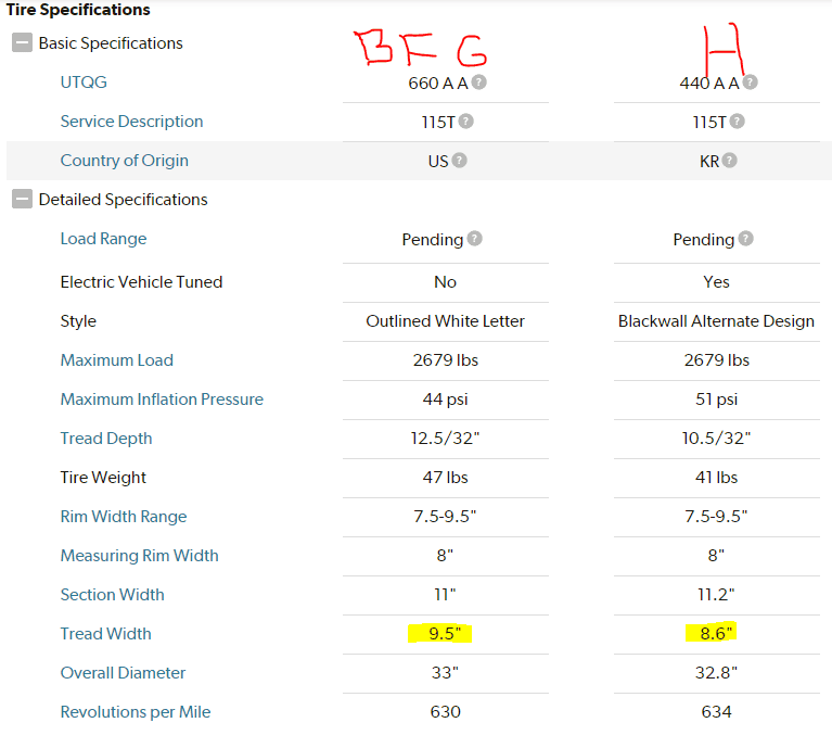

It appears, according to Tire Rack, the BFG is almost an inch wider, so it sits 1/2" further into the wheel well

Is the wheel well liner sitting in the wheel well correctly? that is another thing to consider before trimming

I have the same issue with my right front. For me comparing it to the left, you can see the plastic/fabric liner is bowed out, probably stored bent at the factory, and retained its shape. It shouldn't be that way. I have yet to try it, but I was going to try heating it up and see if I can't reform it to not protrude out into the tire space...but that is a lot of effort for what is a minor annoyance, and it's winter now in MN so won't even be an attempt for another 6 months...

Thanks for the tip with Tire Rack, it makes sense now. I don't think it's a big issue overall, I have to figure out if replacing the liner will help or just trimming it a bit.

If it is just that one corner, I would just trim it, but it's your truck, not mine

It goes beyond a mere product defect. Ford dealers are supposed to inspect the vehicle on arrival. This is clear evidence that this dealer didn’t as any perfunctory inspection would reveal that liner bent towards the tire. That BFG is .2” larger in diameter than the Hankook. My KO2s are 1.7” larger and dont rub at all. That piece is bent significantly and should have caught before they delivered it. Thus, this isn’t just a Ford quality control issue, it is also a dealer one as well.
