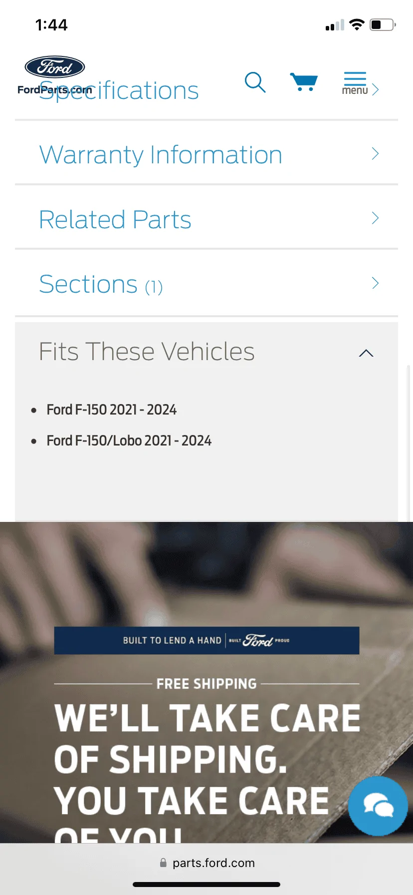

It gave me a part number but don't I need a vin from a truck that hasn't had the auto start deleted to compare numbers?
Starter Motor - Center - 5.0l.
Dearborn Electrical Vehicle.
Part #: SA1179 (11002)
Usage: 11/10/2021, F150, 5.0L Coyote, Kansas City Plant Build
Section: Starter Motor
$301.82.... cheaper than I thought it would be. Picture just looks like a starter.

FordParts says the starter is the same part for 21-24 model year 5.0
