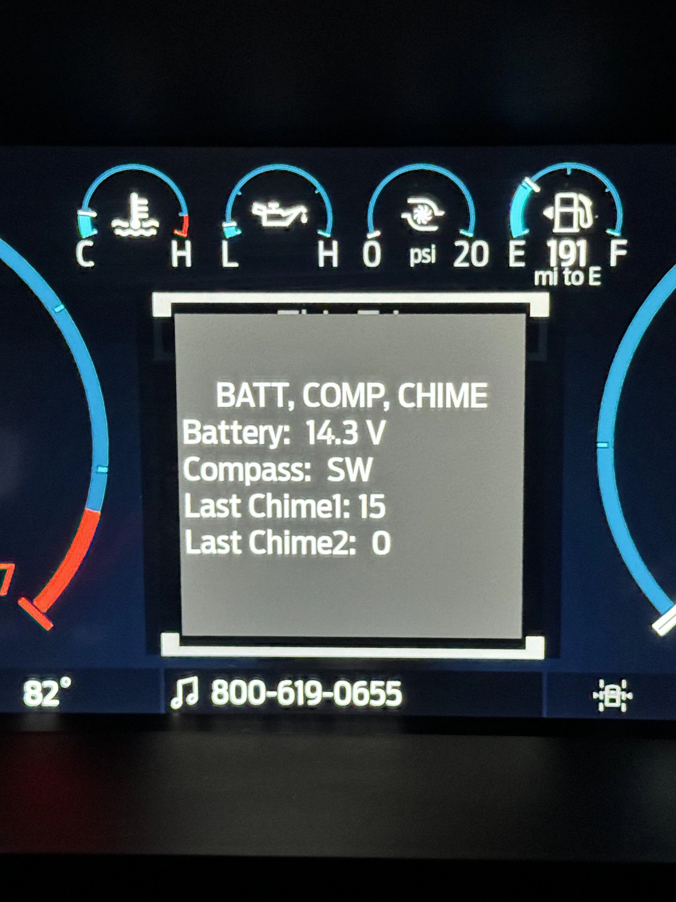

Not sure it matters or if anyone knows what it means but it was dinging from the cluster so I entered engineering mode for the first time. Scrolling through I found a screen for Batt,Comp,Chime. I snagged a picture before I started driving. Means nothing to me but I saw Last Chime1: 15 and Last Chime2: 0. I didn’t get another picture but it changed from 15 to 33 when I started backing into my garage. Again may mean absolutely nothing but I figured I’d share in can it did to anyone here. I also like being able to see the Battery was reading 14.3V the entire ride (~15-20min).
