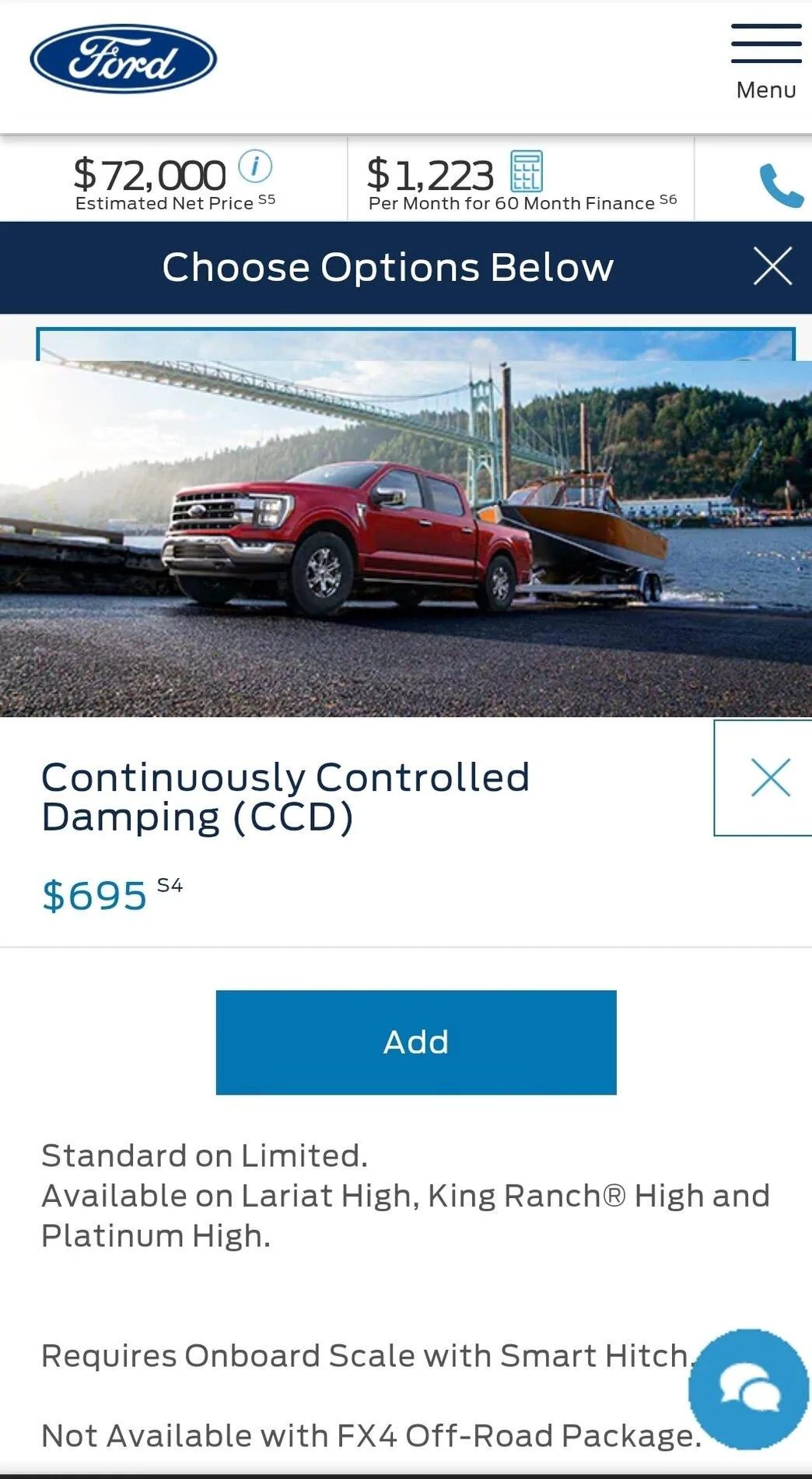

Does your truck have the onboard scales and the electric adjustable shock option?
Wait! You mean the Lightening tech is available as an option on the 2021 Powerboost?
Ahhh, I see it. Yea, not available with FX4 package. Kinda curious what negates it since FX4 isn't really anything special these days. I'd like the scales, but don't think I want to be locked in to oem shocks or coilovers.

I assume "Continuously Controlled Damping (CCD)" has modes mapped to the Drive Modes.
Until there's air suspension, there's only so much the dampers can do, but there are two ways dampers can improve handling beyond being "plush" or "firm":
(1) Low speed compression equates to sway bar stiffness, making for better turn-in (steering into the apex of a bend in the road)
(2) High speed compression equates to ride harshness … a more compliant high speed compression can create a more comfortable ride over typical potholes or rough trails at speed.
CCD option is not compatible with FX-4 (I assume because of the different springs and ride height) and it requires the "Onboard Scale with Smart Hitch" which presumably shares components for suspension position sensors.

From what I can see, only the F-150’s with that shock package could change shock rates on the fly with a switch from normal to sport. CCD - Continuously Controllable Dampers is an option, and it isn’t available with FX4 package.
I’m not saying that there isn’t something else changing a characteristic of the truck in sport mode, but it wouldn’t be the shocks changing because they aren’t wired in to the PCM.
