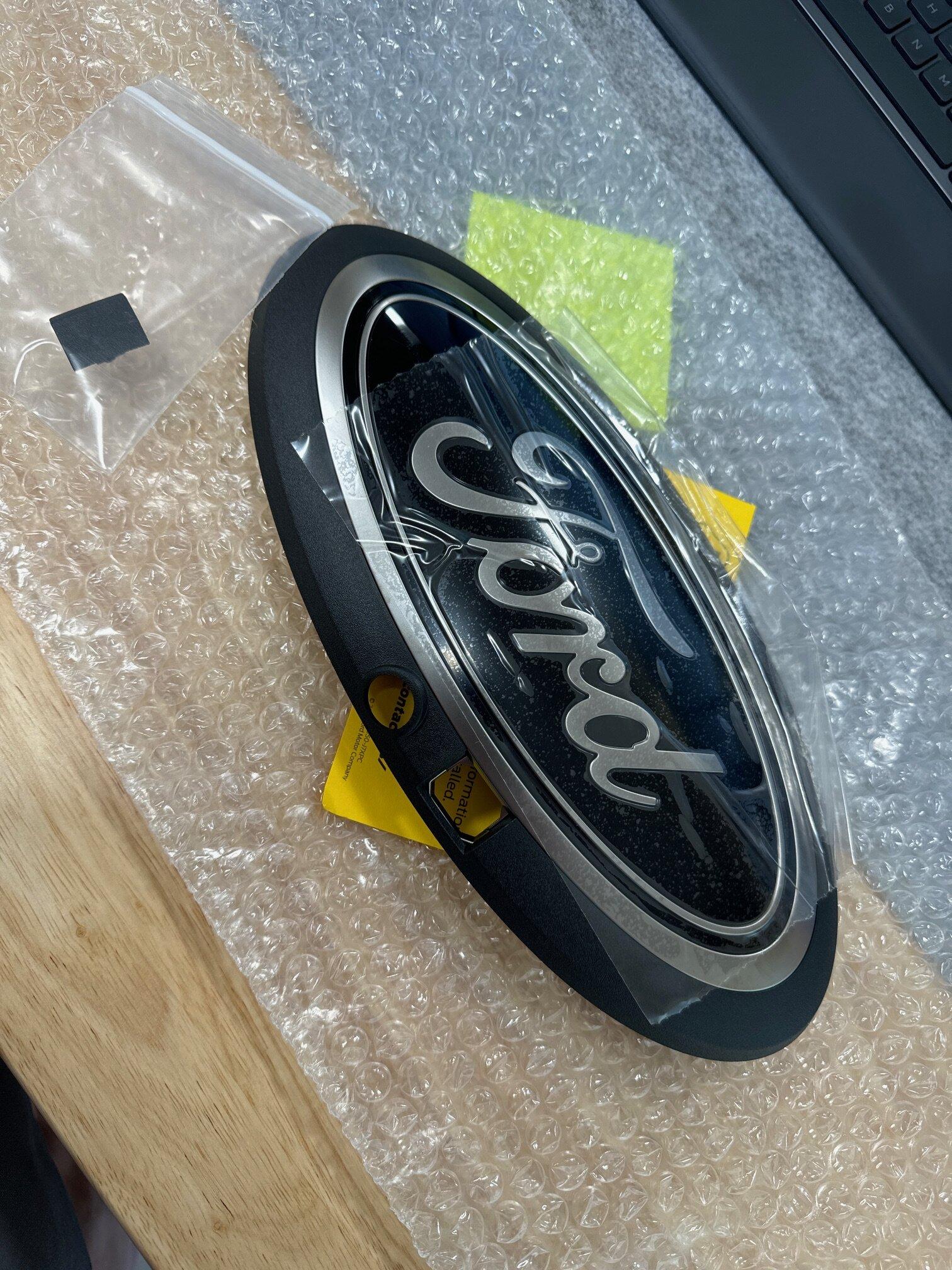

Hello everyone,
I have a 21 that I’m changing the badges to the sport badges. The truck also has a 360 camera set up but as I’m sure you know the front camera does not have a washer. Or does it?
The badge I received from the dealer and only research I found there are only two options for the front sport badge. With camera and washer and without. What do most of you do do you superglue the blank washer cap to use the sport badge?

i would try to glue it from the back with a piece of VHB tape across the back side of the hole then stick the square plug on the exposed tape...it wont come off

Did you ever come up with a solution to this? I just got my badges today and had the same concern.
Quick update: I ended up buying the spray jet (HC3Z-17603-B) as mentioned in this post and it worked like a charm!

Only way I’ll know if I have a washer is it hit the sprayers yes? Or do lariats with 360 cams come standard?
