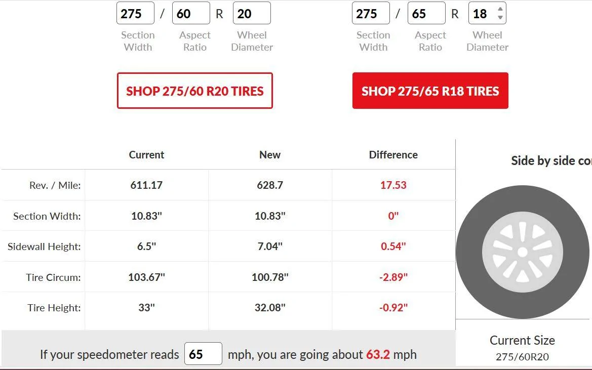

Ford's warning of 2WD only and speeds 70 mph or less are based on the 18" spare (on the right) not having the same diameter as the OEM 20" (on the left).
