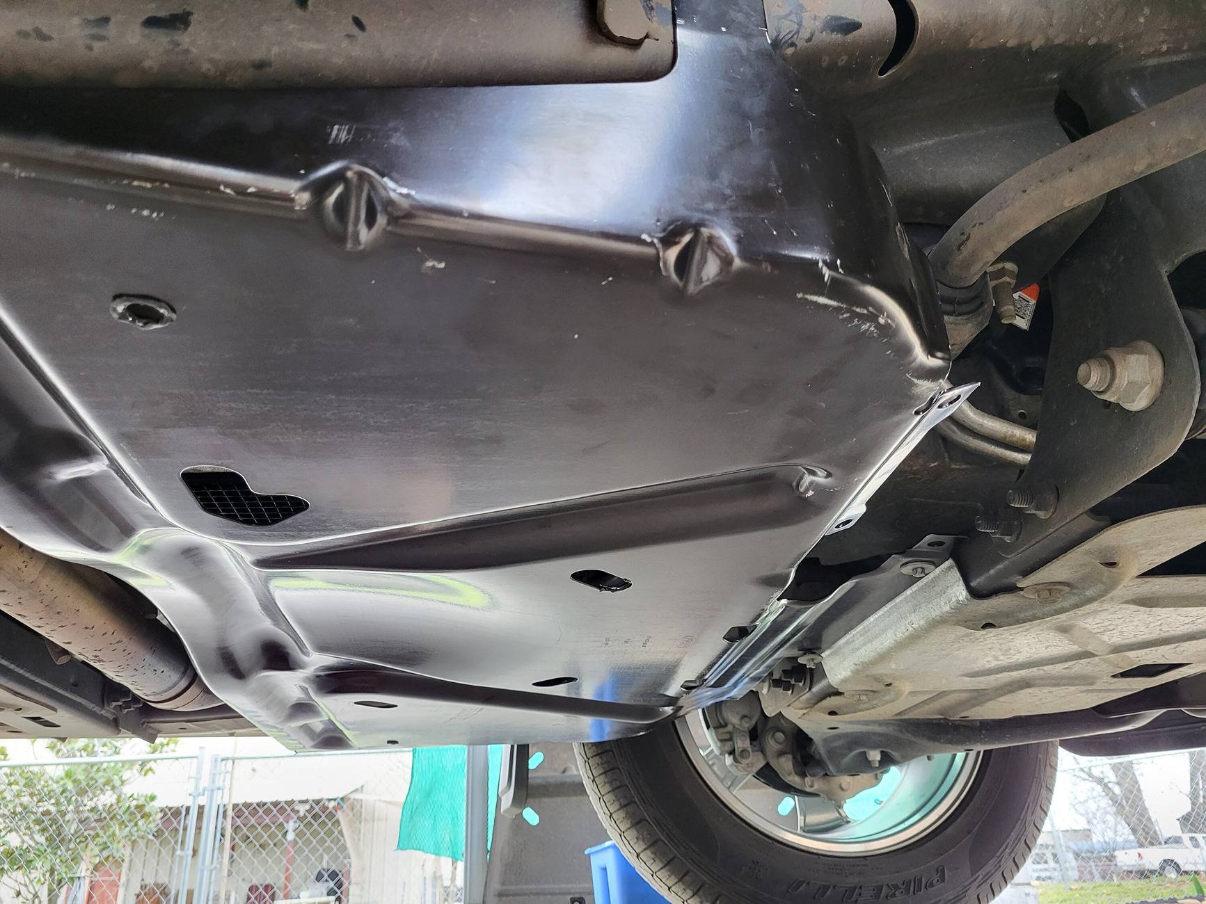

my diaper was replaced by the raptor / tremor plate
as far as noise...only when road debris hits it like a large rock of stuff

I didn’t think anything about it, but I put a couple coats of spray-in bedliner around mine.
I wonder if that has dampened any sound at all?
I used generic dyn a mat on a few high areas on mine..
Did it do anything ....??????
Made me think it did ???
I’m really not sure. My thoughts were mostly about corrosion protection……or at least an added layer of protection

I also used some to act as a anti rub on frame where the metal was bolted to frame
