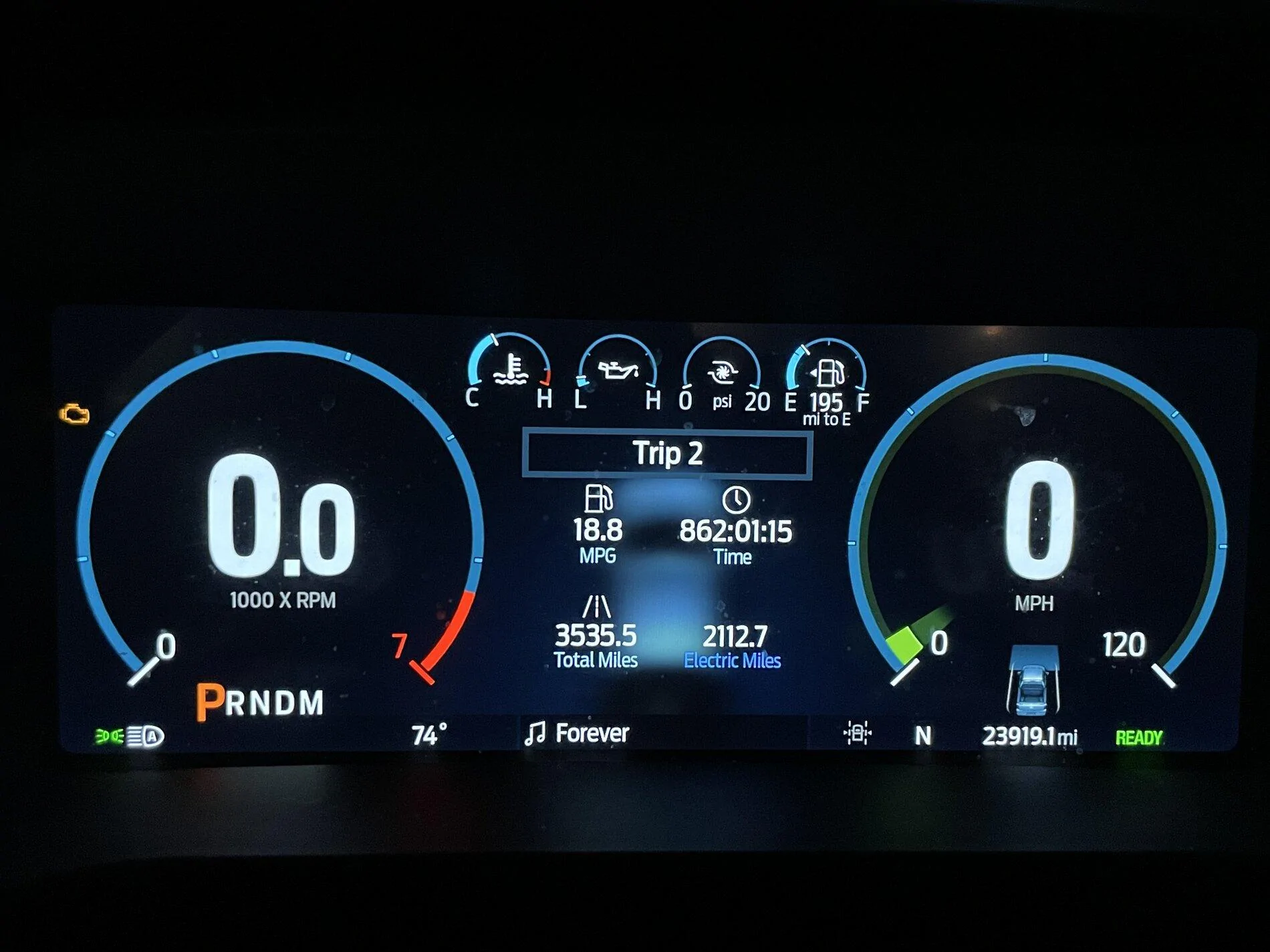

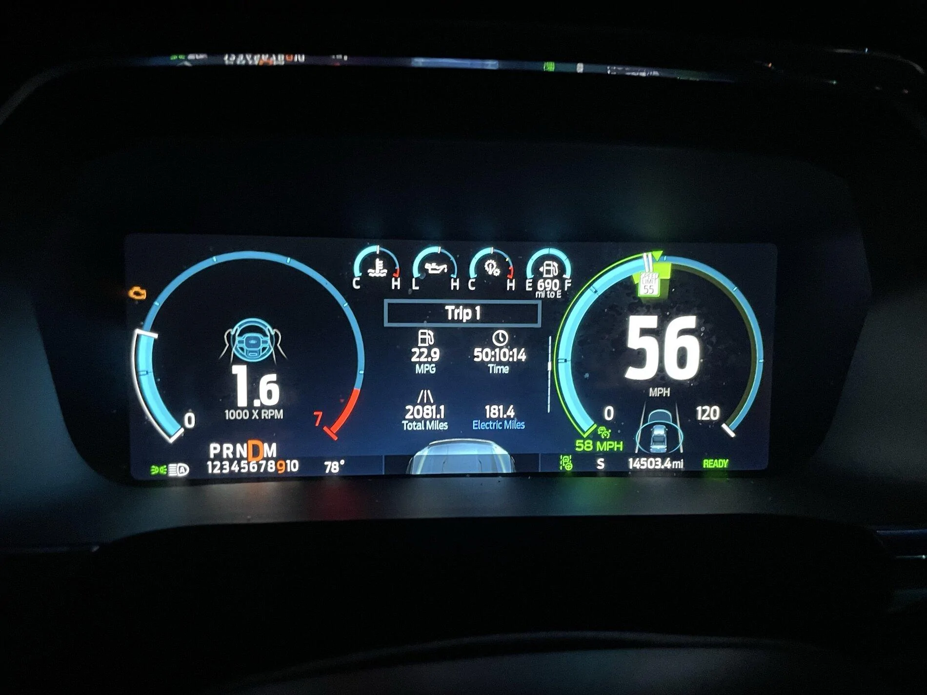

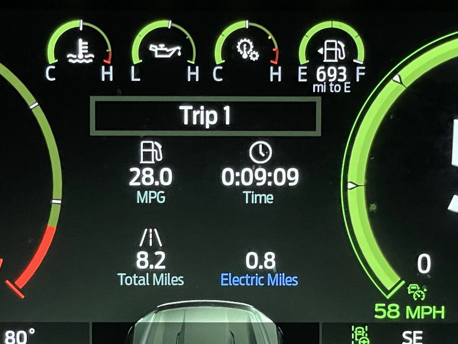

I have 23,919 miles on a Hybrid truck and I can assure you the the cold affects the battery. When in the 20’s the hybrid power was noticeably less. Cold affects all hybrids and battery cars.
With regard to not running it for long periods, You can set auto cranks for certain days if the week and it will run for 15 minutes.
4x4 truck will get the 24 and 24 MPG, and sitting in the truck working saves $$$ compared to my last f150. I might average 12mph after a couple thousand miles because of my working in the truck between jobs.
you can order a power boost truck in an XL trim, which saves $$$. The gas savings alone is a no brained for me. The pro power is another one. It runs a camper great! Probably 125 hours running a 30 amp RV.
FYI: on picture of trip 2, the total miles count has the 1 is cut off on the left side. It should be 13,353.5 miles. So the truck gets 18.8, but it goes 100 MPH fast, so I think 19MPG average over the lifetime of the truck is wonderful.
