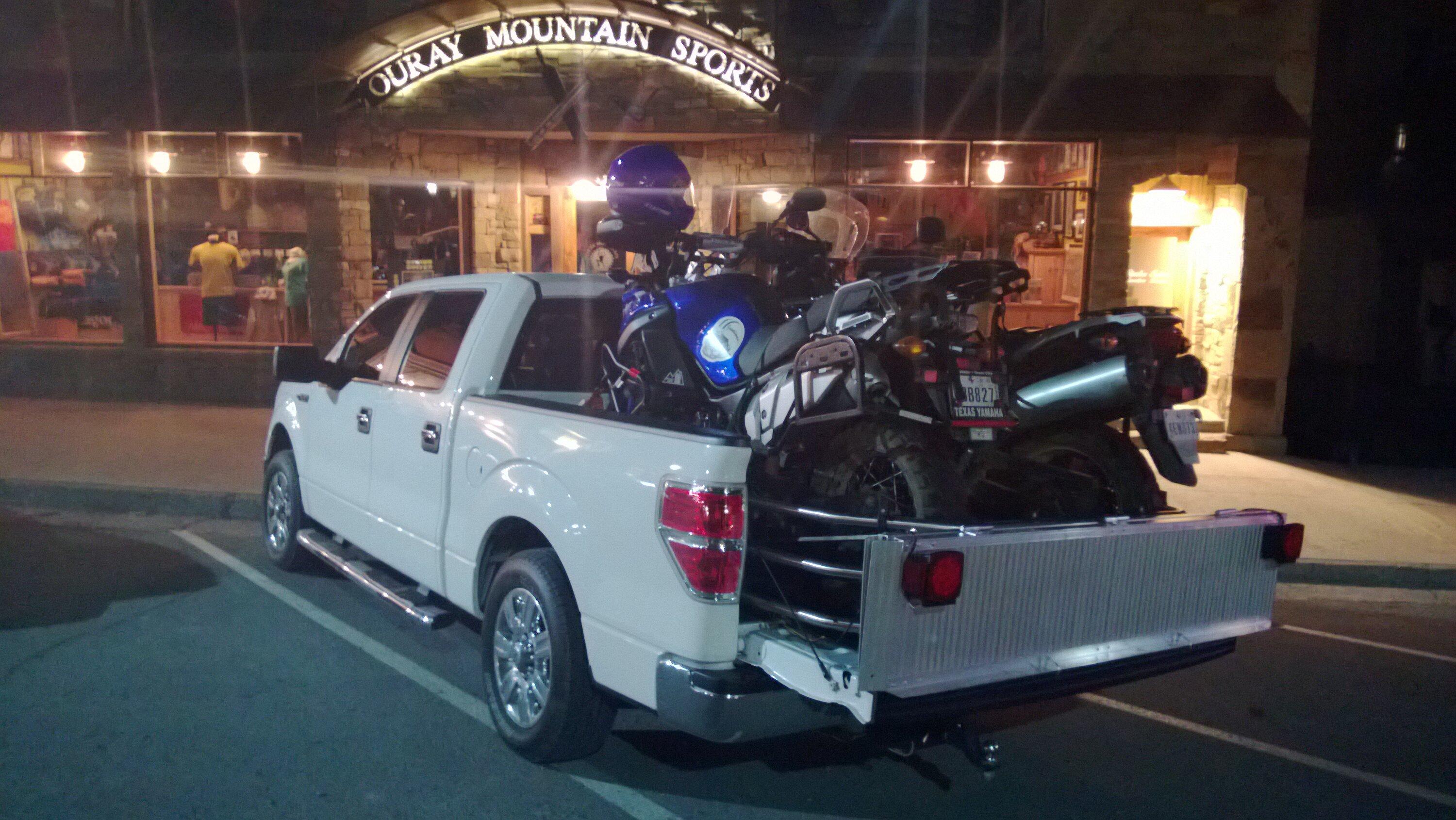

If a WDH isn't involved, I think Airbags are the cat's meow for managing weight distribution.
Especially if the heavy loads are truck-bed oriented.
I used them when I was carrying 1200#'s in the bed. A perfect solution to get that weight back on the front axle, which makes a huge impact on the driver's comfort.
Ford F-150 Silly question...how long is the bed? WP_20130709_002
I still think Airbags are a great solution when a WDH is involved, but only for those who truly understand their WDH and know how to strike the proper balance of using 2 overlapping methods of accomplishing similar burdens.
