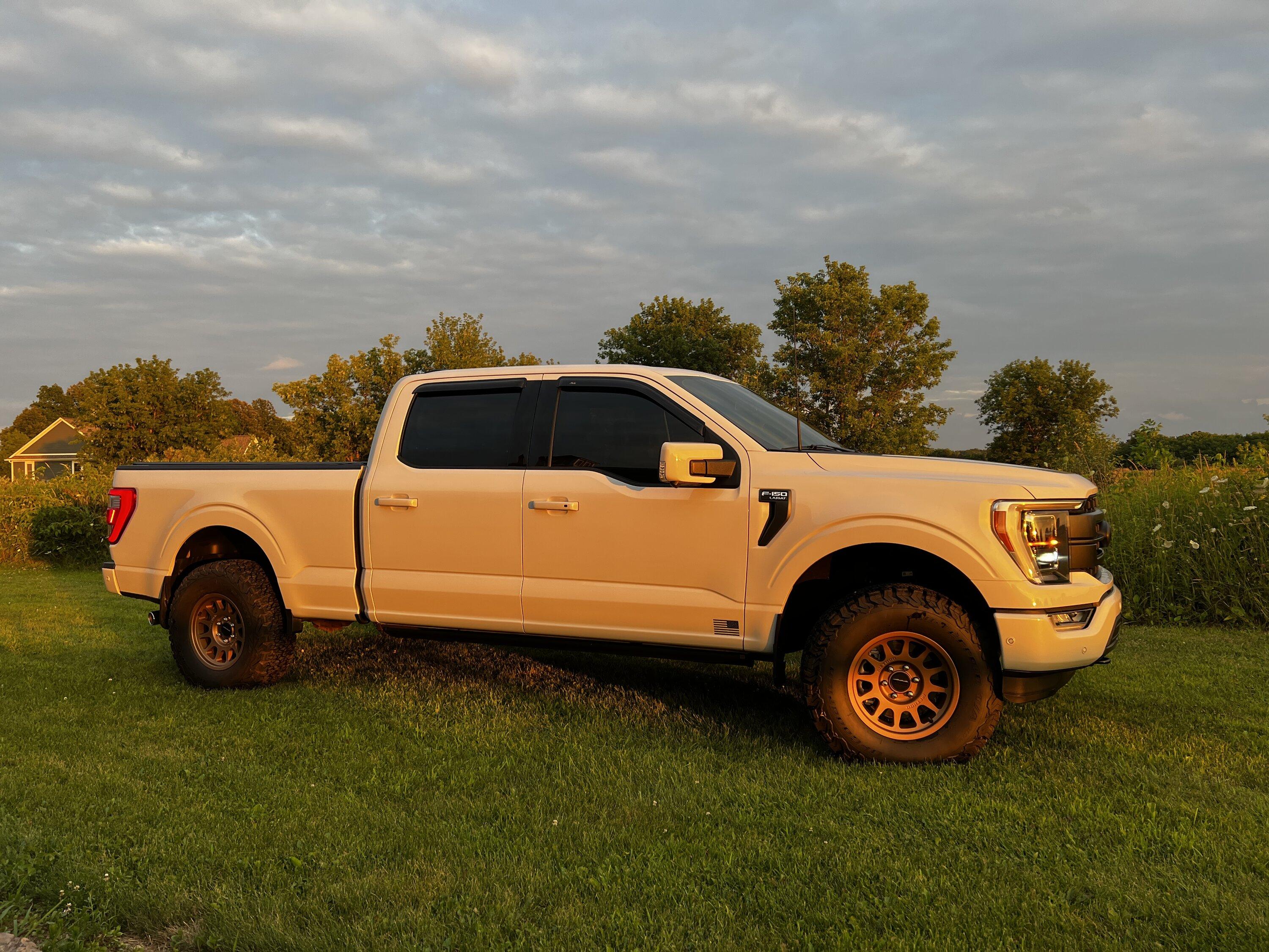

So the local tire shop only static balances my method wheels with K02s on them and I keep getting a small shimmy at freeway speeds. Is there a certain kind of shop that can balance my wheels with a road force machine?
