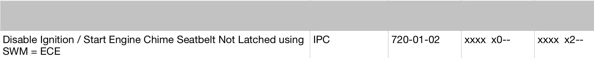

@Dvcpro13: Matt, These are all the seat belt chime related settings that worked for me, worth checking maybe ?‍♂
Non-As-Built:
Ford F-150 Seatbelt Chimes IMG_4468
As-Built:
Ford F-150 Seatbelt Chimes IMG_4469

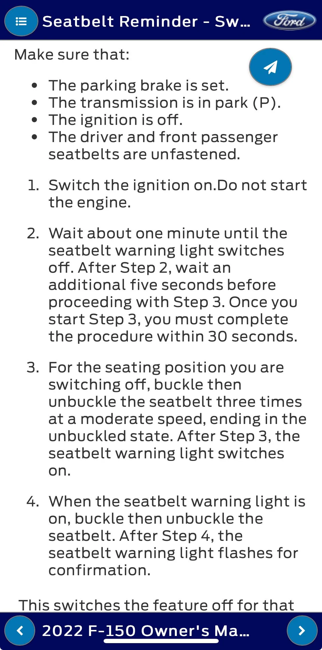

Did you know you can disable them without forscan?

This is actually better than using forscan. It’s less changes you’re making to your as built data. The more you change in forscan the higher likelihood that something will start working odd. This doesn’t affect any other code. It’s baked into the cake from Ford.

I did not know that! I'll give it a try. Nothing else is working for me. Thanks.
That feature is in the owners manual.
I want to say doing it this way isn’t permanent and it will revert at some point but the owners manual doesn’t clarify this that I could find so maybe it does stick.

I've used the owner's manual method successfully several times. When I let the dog ride up front on hunting trips, I turn off the passenger seat chime. Can turn it back on later. Just be patient and methodical. Doesn't hurt to do a couple "practice" runs.

Strangely my seatbelt warning light won't turn off in step 2. Tried a few times now. I wonder if it's because I've got it disabled in Forscan? I am in Canada, the Nanny Capital of the world too so that might have something to do with it? That's probably a stretch.
