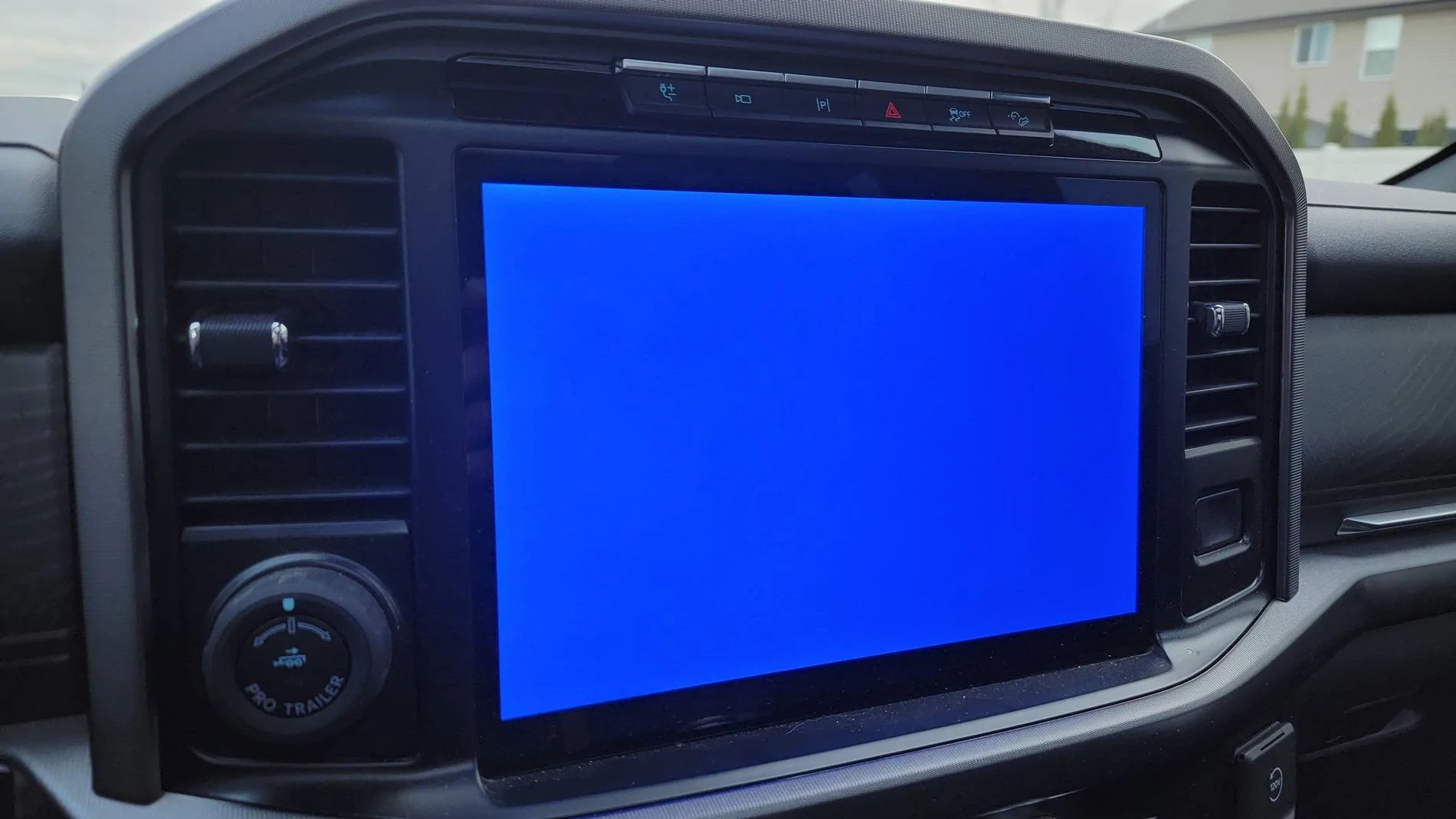

This morning my screen wouldnt turn on at all, stayed black. After about 8 mins, the screen turned solid blue for about 60 seconds, then went off again and continued this process, bavk and forth, until I got home. When I turned the truck back on, I am able to see half the screen but Maps werent showing, like they normally do.
Anyone else seen this?

Hey there! Can you please send over a message with your VIN and estimated mileage? I would like to see what I can do to assist with your screen concerns.

Possible a APIM Issue
I would try doing a soft reset.
On the steering wheel hold the right volume button and the left button on the other side of the steering wheel until the screen goes blank and release the buttons

Weird. I just checked your VIN, and it is not reporting any APIM codes. Very strange.

Thanks Javi, what was my SoC at the time? Ive been putting off getting a battery, maybe I am getting closer to that finish line?

81% SoC and 13.1 volts.
