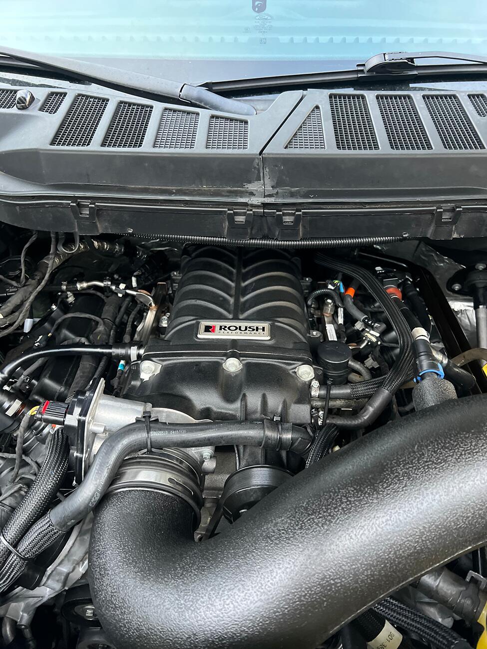

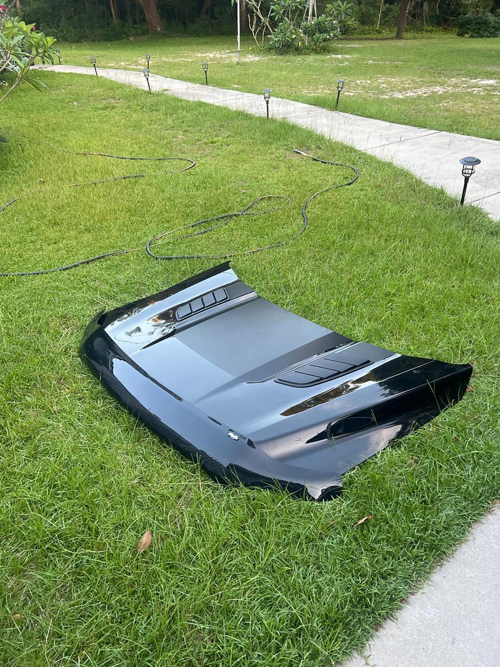

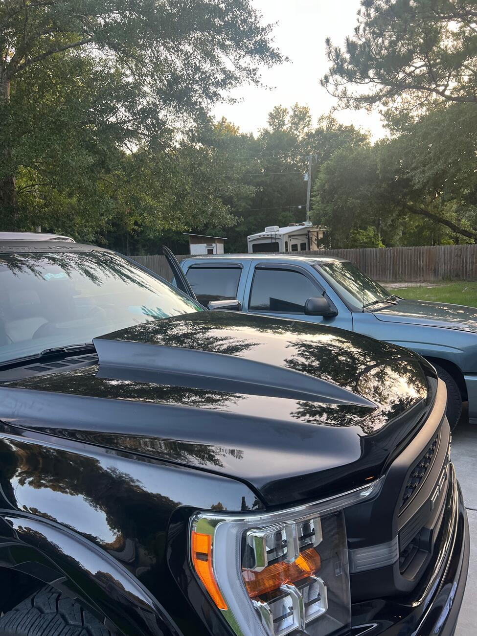

I got my girl back. The new tune has done well. I drove it to Pelzer sc from Mississippi, then to Gatlinburg, then to rock city. We put 2k on her w/o a hiccup.
Now she has 19.7k on her and 2300k on the new s.c. 5.0.... I played Ozzy "coming home" leaving the dealer. cervinni hood installed before said trip! It's good to be back initiating surprised faces and hurt feelings.
