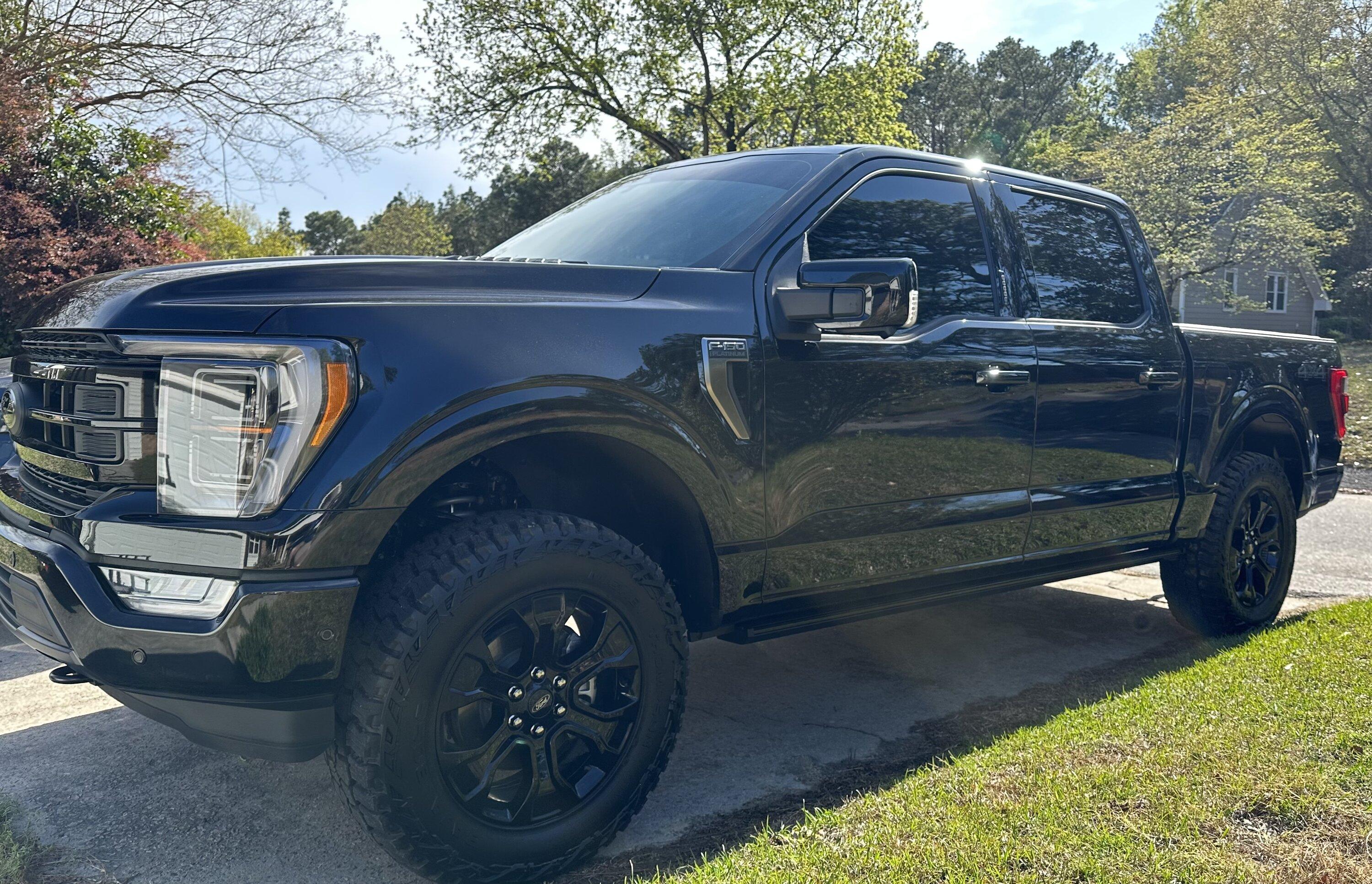

I am looking for feedback from real world experience testing both Roush and Ford Performance suspension upgrades on the F-150. I currently have the Roush kit with Fox 2.0 on my 2023 F-150 Platinum with 5.0. I do have the Fox coilovers adjusted for 2.5" in front but my issue with the Roush Fox kit is stiffness. When I hit a pothole or uneven pavement, I really feel it! I'm considering swapping them for the Ford Performance kit adjusted to 2.5". Those of you who have tried both, which would you say provides the better ride?

I would highly doubt the Bilsteins would ride better than the Fox 2.0's unless there's some sort of drastic geometry difference between them. Also, it's weird to hear they ride that poorly on a Fox coilover as that's usually not the case. What are you running for tires and tire pressure?

I am running Micky Thompson Baja Boss AT tires at about 33 lb. The Ram I had before this F-150 had the Mopar Fox coilovers with Nitto RG tires and it rode like a dream. I'd really like to get a better ride quality from my F-150

I have personal experience with the 2015-20 Ford Performance (FP) Fox 2.0's and the 21+ Fox 2.0's on my 2022 XLT. I have read that the Roush kit is the same as the off the shelf 15-20 Fox 2.0's with added roost guards. For the sake of clarity here, I am going to talk to three versions; the "FP kit", the "Roush Kit", and the "21+ kit", which covers what I have run to what you are running. The FP kit has 550lb springs vs the 650lb spring on the Roush kit, along with revised dampening. The FP kit is intended to be a more comfortable kit over the Roush kit. I ran the FP kit for about 6k miles before replacing it with the 21+ kit. I thought the small/sharp bump compliance to be quite lacking and it had a jarring ride. The 21+ kit has a 450lb spring and revised dampening to agree with the 21+ suspension geometry. I can say that I am quite happy with my decision to go with the 21+ kit on my truck. I feel that it rides quite a bit better than the FP kit I was running. The FP kit rode a bit rough for me, so I can imagine the Roush kit rides even that much worse, especially since you have them adjusted up, outside of their specified range.
As always, the higher you go, the rougher it will ride. If you can stand to drop it down a bit, then the ride should only get better. Also, LT rated tires, especially anything over a load range C, will ride a TON rougher than the standard P-rated tires your truck came with. It sounds like youve already lowered your tire pressures, so if you plan to keep the tires, all you can do is either lower the front suspension to obtain better ride quality, or replace it with something else. My advise would be to look at the 21+ Fox 2.0's, as the Bilstein 6112/5160's are on perpetual backorder (which also means the FP bilstein kit). I suspect you'll see quite the ride improvement.

Pretty much to echo was AHenry014 said - if the spring load rating is that much different then I would imagine yeah, the 21+ kit will ride substantially better. Also yes, if you have them things maxed out they are gonna ride like dirt. Also yes, running an LT tire, of which I'd imagine the ones you have are load range D, will ride way rougher than the stock P rated tires.

Ditto.... I have the 21+ FP kit set at 2.0" (default setting). I'll add that when I went from a 305/55R20 LT (Generals) to a 305/55R20 SL (NRG) night and day difference in performance, ride quality and handling. Even at 33/35PSI I seemingly felt every pebble in the road on the Generals; I was miserable....
What I'm trying to say is, LT tires are heavy and stiff side walls.....maybe the tires aren't helping...

I always tell people only get the LT tires if you actually are planning on being offroad somewhere that you are worried about puncturing the tires, or if you are needing the proper load rating that would be an LT. They definitely ride a lot rougher and you have to keep them aired down to try and maintain a decent ride quality. More tire plies means a stiffer tire.
