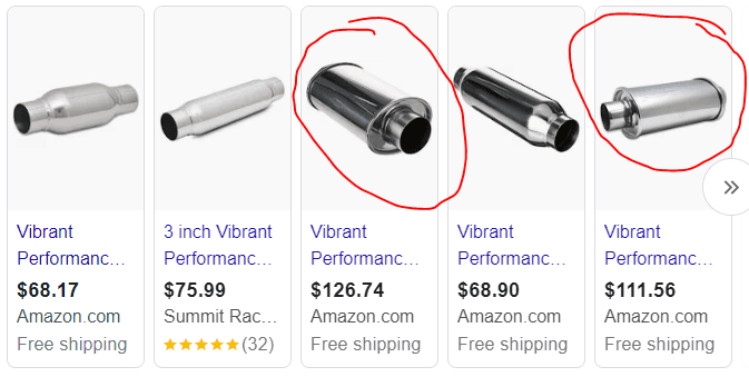

Reference my workup that i included from service and it even has the parts breakdown if i'm not mistaken. Your easiest fix is to have someone do a Vibrant resonator (highly suggest this brand) if you can't get them to budge. Not super expensive and a high quality muffler shop will fix that for good. As you can see here, they don't cost a ton and usually the muffler shops have them in stock.
