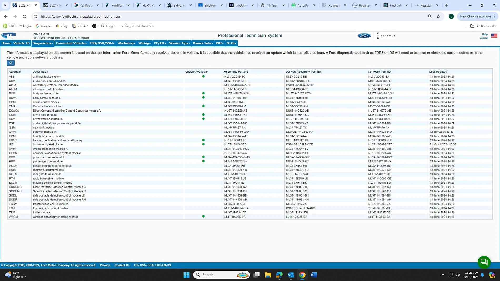

Could I get you to check Vin # 1FTFW1ED9MFA85627 for updates? Been told there is an apim update coming to resolve my Infotainment from rebooting every 15 minutes while driving.
You're on the latest Sync version and show very little pending. If you are referring to the Sync update coming in Q4 to address Sync issues, nobody knows when Ford will release it.

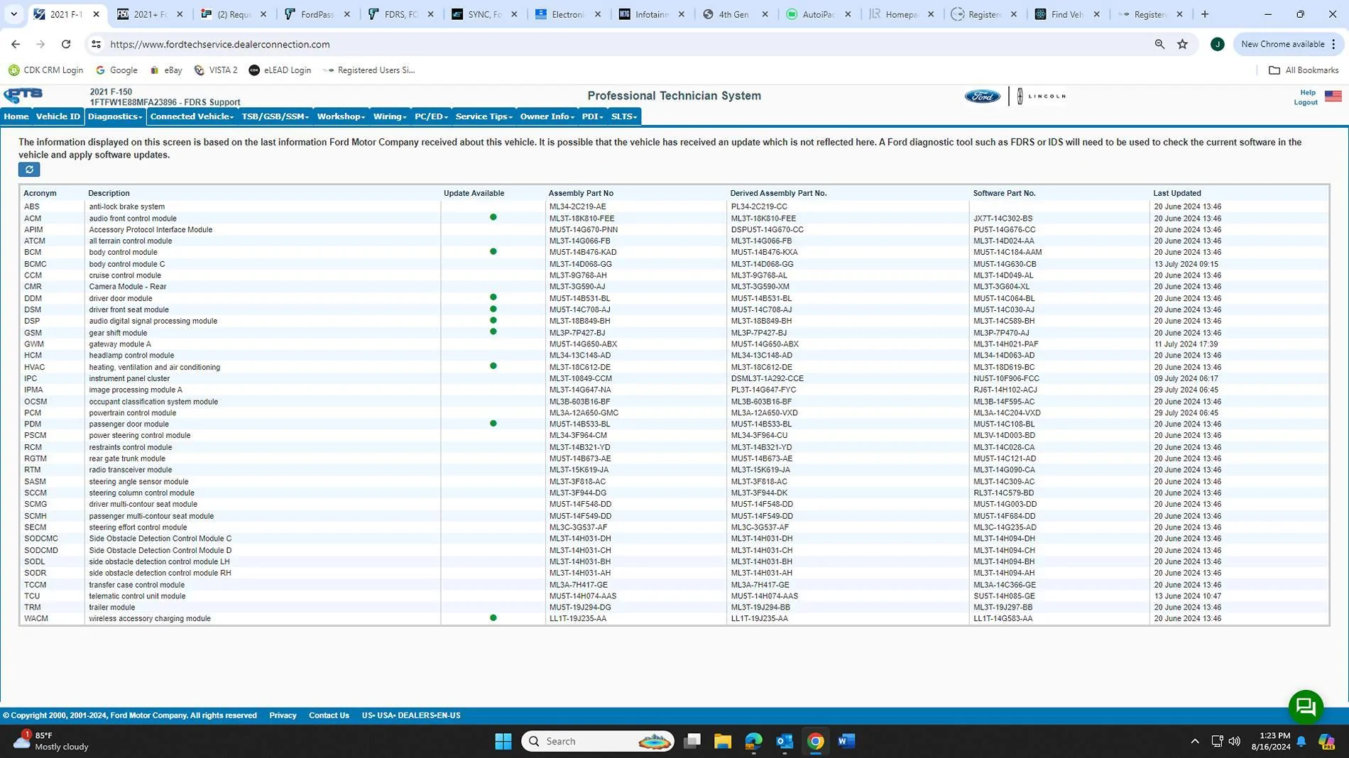

Can my updates be checked? 1FTFW1E86NFA93608
Your truck is on the latest Sync version and pending update are below:

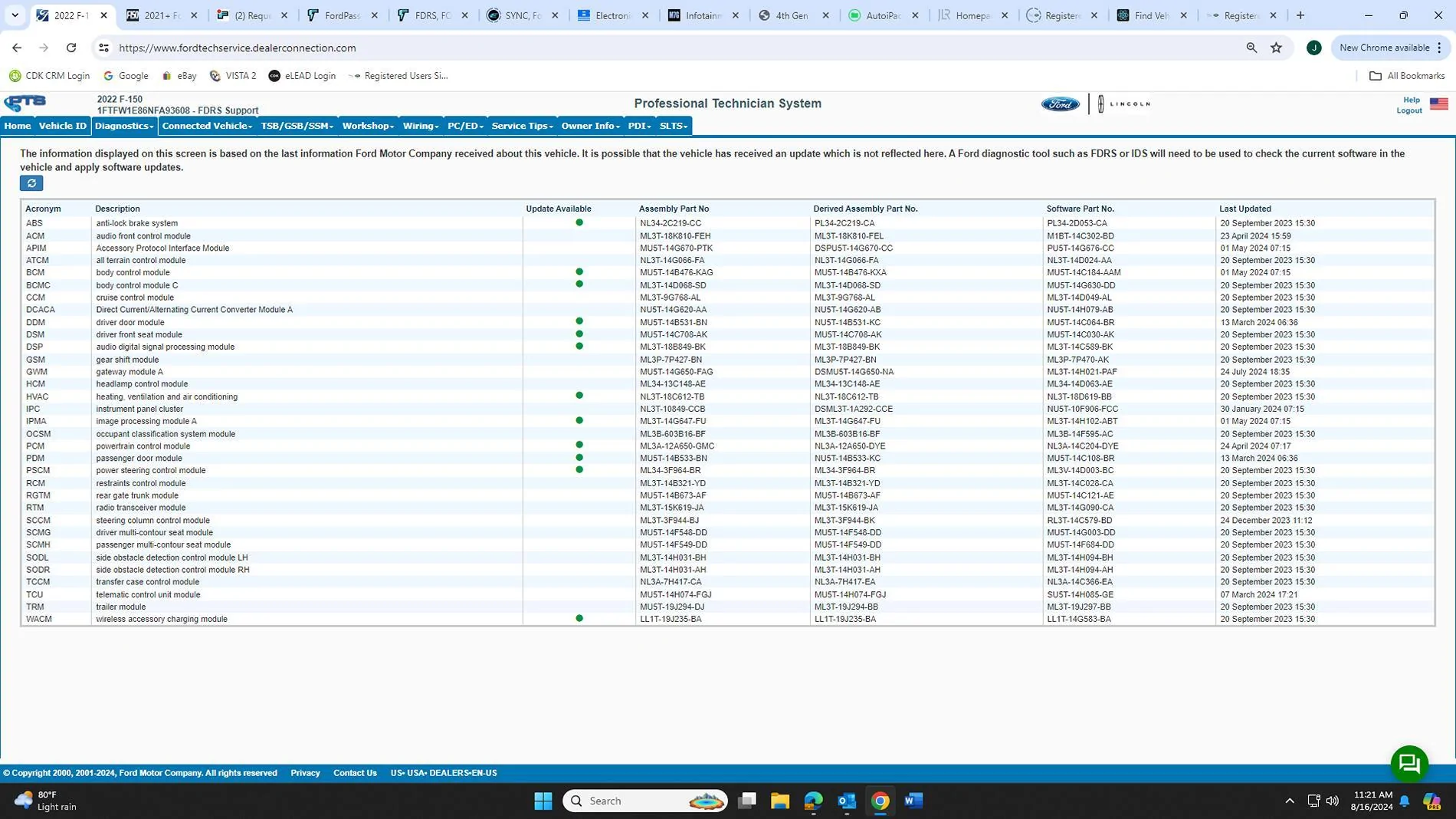

1FTEW1E81NFB07944
I’m stuck on the door lock update. It’s been a while since any update went through. I’m looking for the new audio update as well. Can you tell me what my status is and also is there a blue cruise update available for my truck. I still have two years, almost left on my subscription and went on a trip and I don’t have the plane change with the turn signals enabled which I thought was in a newer update..
Your truck is on the latest Sync software and modules pending updates are below. At this time, there is no active OTA trigger for your truck, so if you are seeing a message about an OTA, it is a phantom message and you can ignore it.
The updated needed for lane change assist has not been sent to any F150 via OTA yet. To do it, you would FDRS and FORScan. In your case, however, you cannot do it at all. The IPMA update needed to enable that is not being released for Tremors or Raptors.

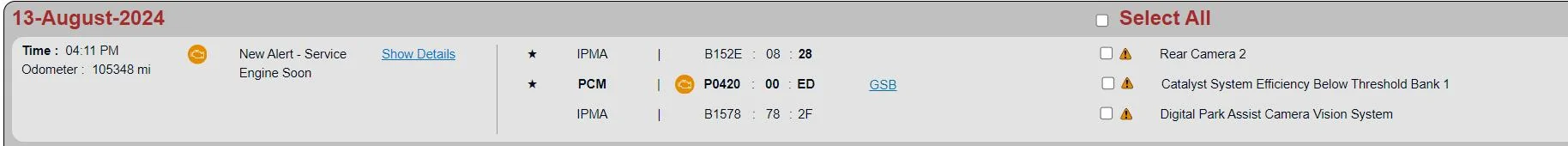

1FTFW1ED2MFC62678
Can you check this VIN for anything to do with drivetrain? Having shuddering issue.
This is a possible mechanical issue and virtually impossible to diagnose remotely unless the truck is reporting a code that is directly related to the problem. The only thing I can see powertrain related is the PCM code below. The GSM it refers to is attached. This is for the catalytic converter so can't say the issue is related, but at least it'll get your foot in the door at the dealership so they have something to look at.
