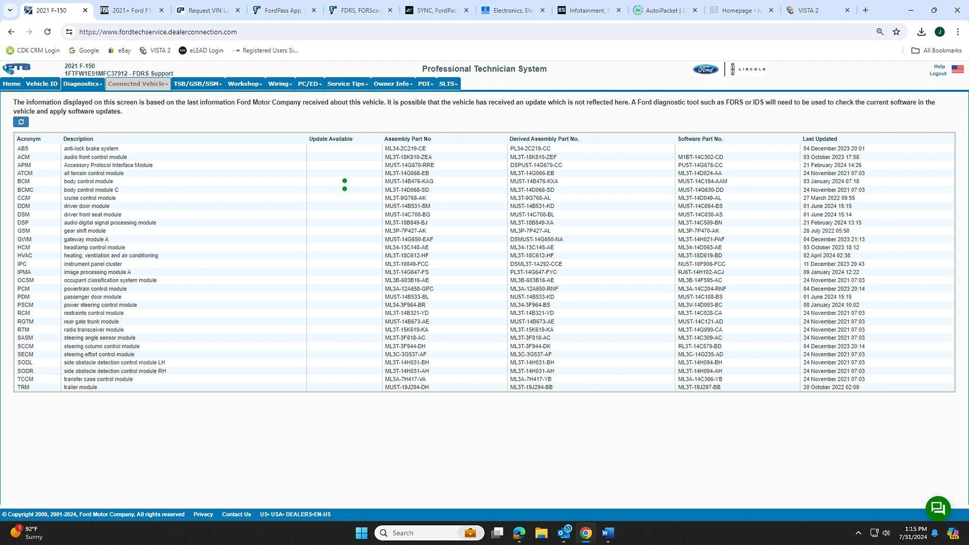

@rugedraw Can you please check out if there is any available updates in FDRS for my truck.
VIN# 1FTFW1E51MFC37912
Thanks in advance, really appreciate your effort and help.

I don't have access to FDRS at work, but this is what PTS is showing. Not much.

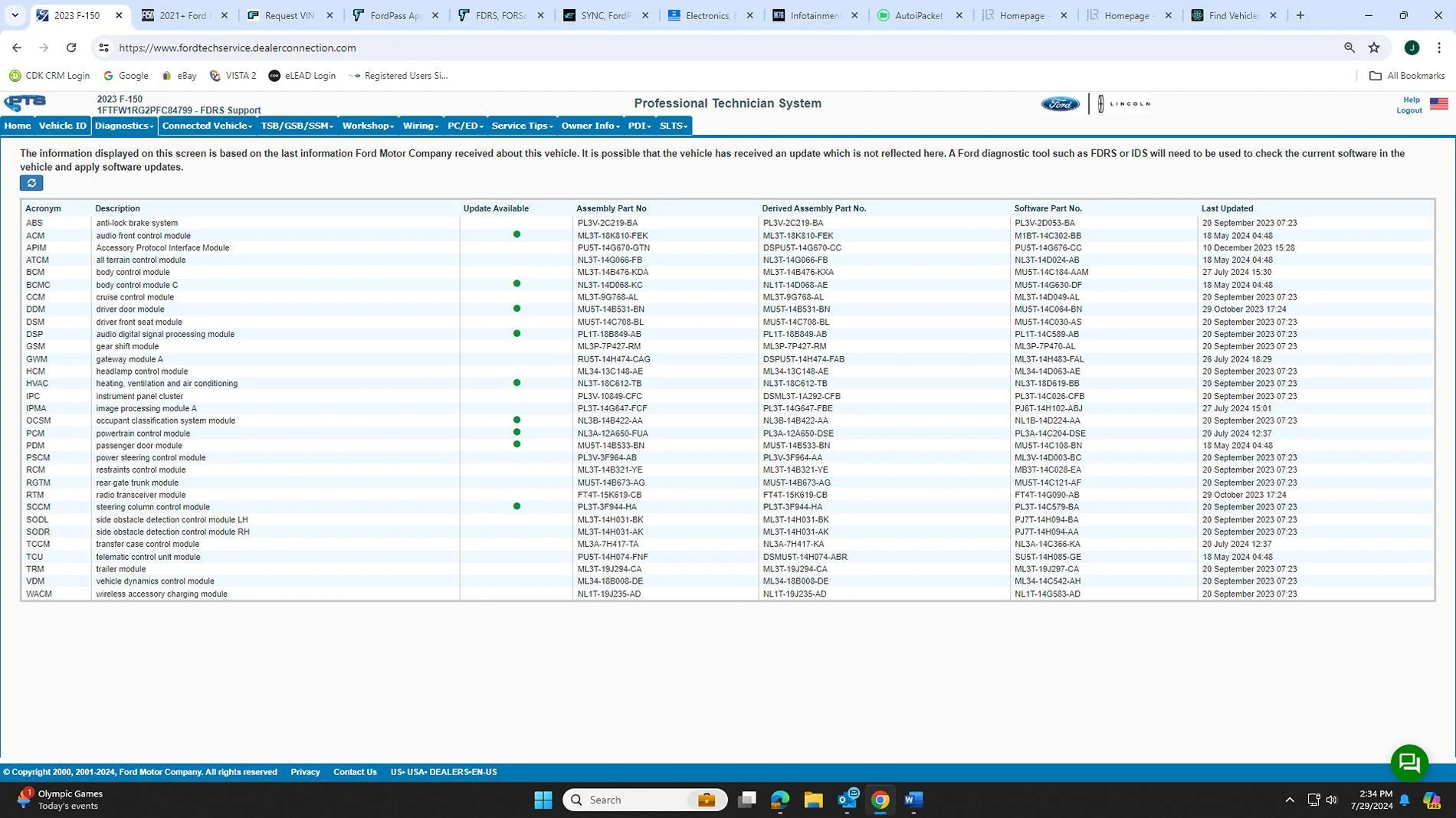

Can someone please check my vin for updates. Thank you
1FTFW1ED3PFB11188
Truck is on the latest Sync version. Modules pending updates are below:
