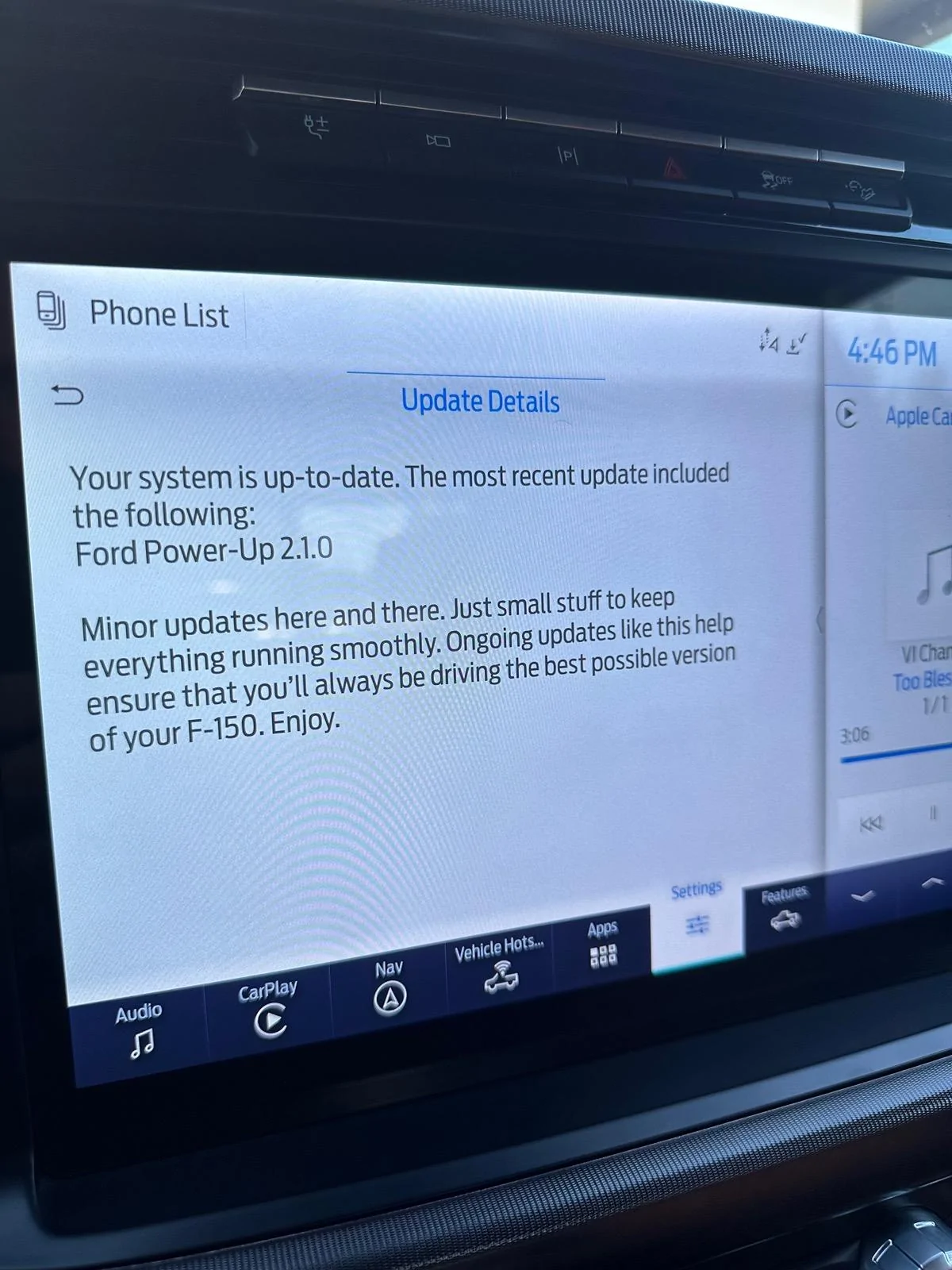

Just received this….

Sweet! Only 57 more updates to go. lol
At least you now know your APIM swap was correctly done.
57!!!! haha sounds like I’ll need more then a 2 days FDRS license!! What exactly is the Ford power up 2.1.0. I noticed my version number didn’t change.
It's an old GWM update. Only an APIM update has a chance to give you a higher Sync version.
