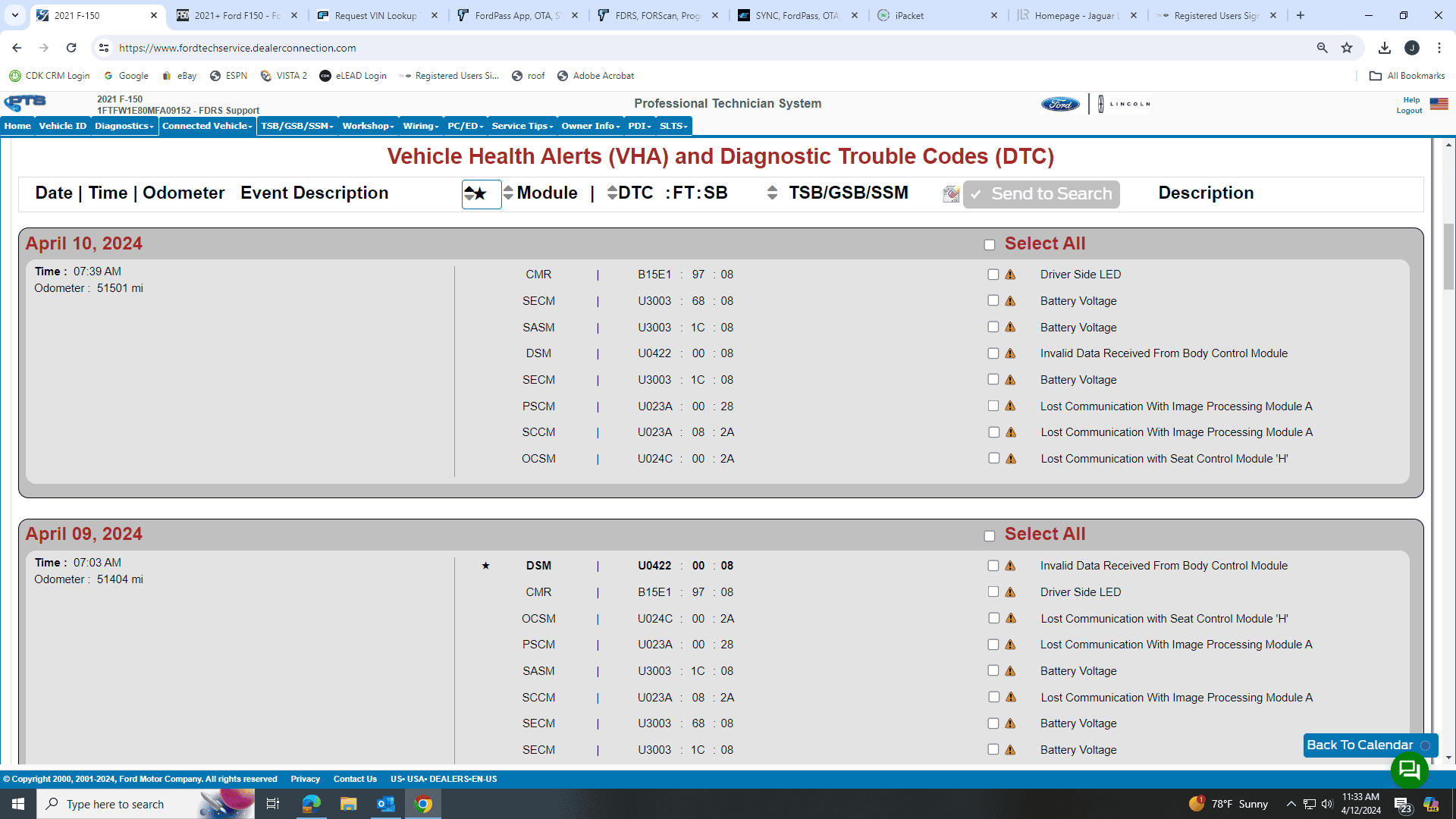

alright I'll see if I can try and get access to FDRS tomorrow and update that one. Also after updating I got a DTC SCCM - U023A:08:2A any idea on how to fix?
Before you spend the $50, do you remember what FDRS said was the reason it would not update the IPC?
It's a lost comms code with the IPMA. I see these codes all the time, and they don't really mean anything. If there is nothing wrong with the truck and no lights on the dash, I would ignore it. I'd be more concerned about the health of your battery. It is reporting low voltage to the cloud and has been for months.
No I only remember it just failed each attempt. I recently purchased the truck so don't really know how long that battery sat, if anything ill warranty it out.
