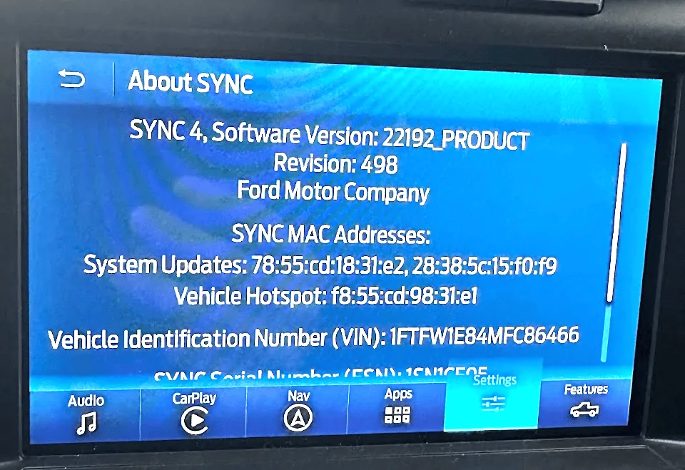

Interesting. I don't ever recall seeing Sync version 21008 before, but PTS is showing that same Sync version. It is very old.....that is from 1/8/2021. I see the dealer was able to recover your existing APIM and they updated the APIM, GWM and the TCU (they struggled getting the TCU updated, but they eventually got it) which are all good things.Hello. I purchased in late December (of 2023) a new-to-me 2021 F-150 and am wondering why the Sync 4 software version is at 21008_Product Revision 252.

The first the update failed is because the OTA trigger expired before anyone started the truck, but chances are, it would have failed anyway. The OTA update failed the 2nd time due to a manifest issue, but it seems like the OTA process is working and trying to do what is needed to fix your truck. I would wait a bit to see if the ship rights itself. As far behind as you are, I recommend you look into FDRS and updating the truck yourself as the OTA process will take a veeeeeeery long time to get you fully updated.
