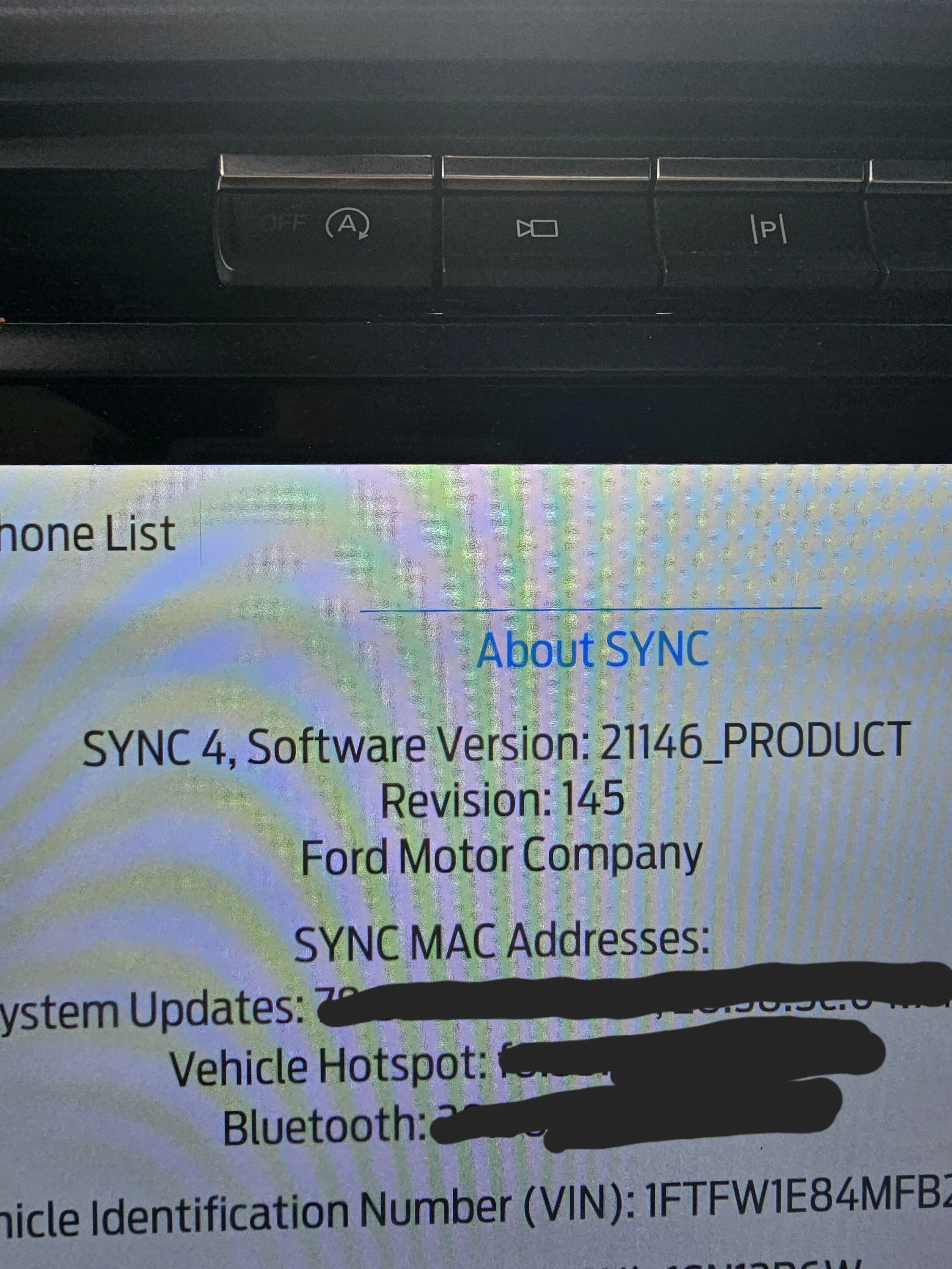

Can someone check my truck please?
Had a new apim installed and dealer said it's all up to date. I bought a mongoose in case I need to do the updates myself.
1FTFW1E84MFB25213
TIA
I see they did some work on your APIM, but I do not see they PMI'd it. Please post a pic of your "about sync" screen on your touchscreen so that @Jesse-Infotainment can look at it and comfirm. If you have the Mongoose, you can PMI it yourself, but if I am right, you would need to do that first before starting to update modules.

PM him the screenshot directly if you don't want that info public. Tell him the dealer recently replaced your APIM and you want to know if it is properly configured to your truck.
Yup. Just messaged him. Thank you

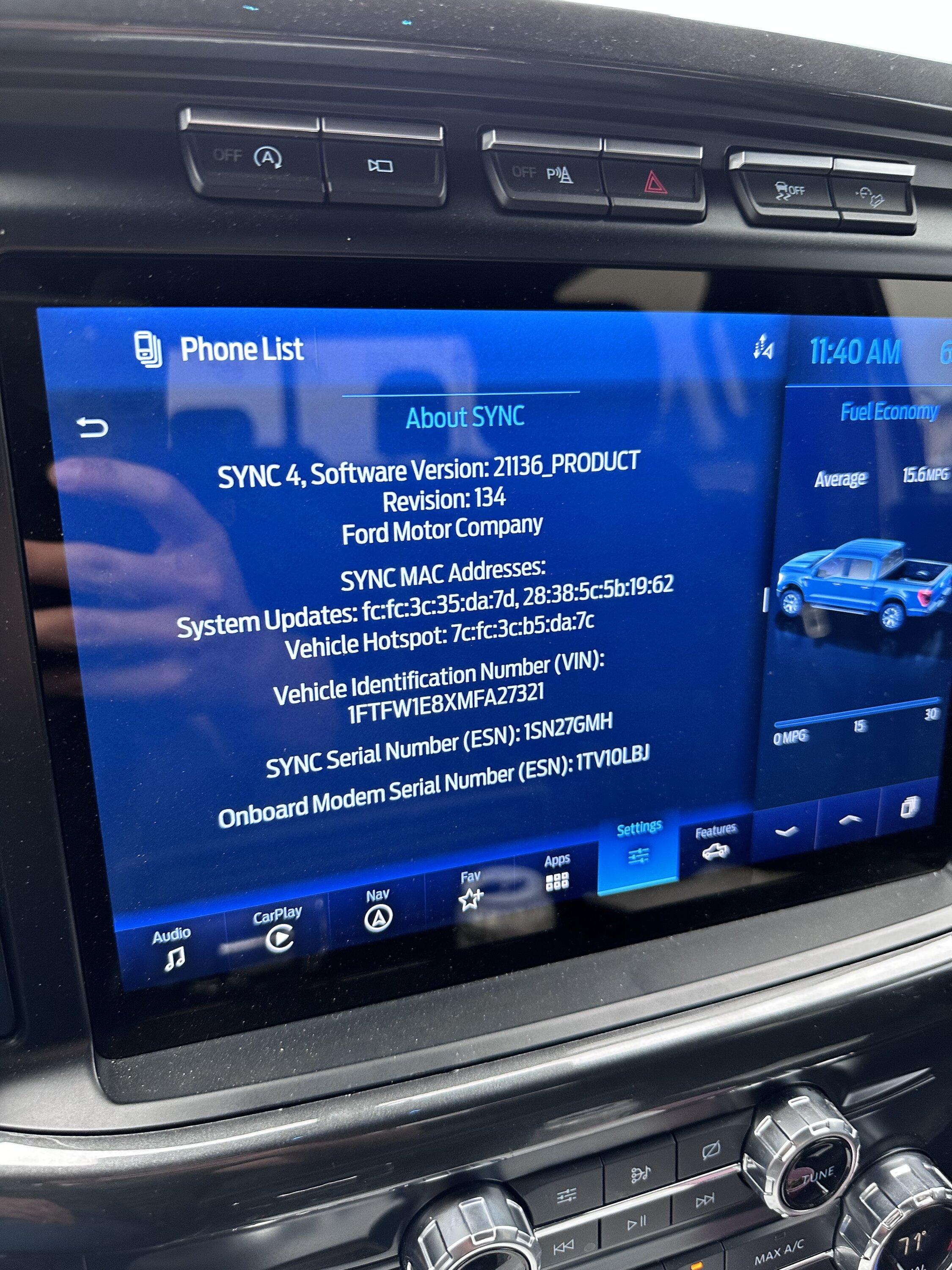

I just got a new apim in my 2021 F150 XLT and they say it is up to date.
VIN 1FTFW1E8XMFA27321
Shows software version 21136 and I’m not getting full screen Apple CarPlay.

You are no where near up to date. They tried to perform the PMI on the new APIM twice, and both times it failed. It is possible that they released your truck with the new APIM not being properly configured to your truck. Post a picture of the "about sync" screen on your touchscreen so Jesse can verify if your truck was properly fixed or not.

@Jesse-Infotainment 1FTFW1E8XMFA27321 This truck had an APIM swap and no PMI done. Can you check and see if his truck is properly configured or if he needs the PMI done?
@RH F150 If he does not respond, I would PM him directly and ask. He gets a lot of @s and can easily miss some.
