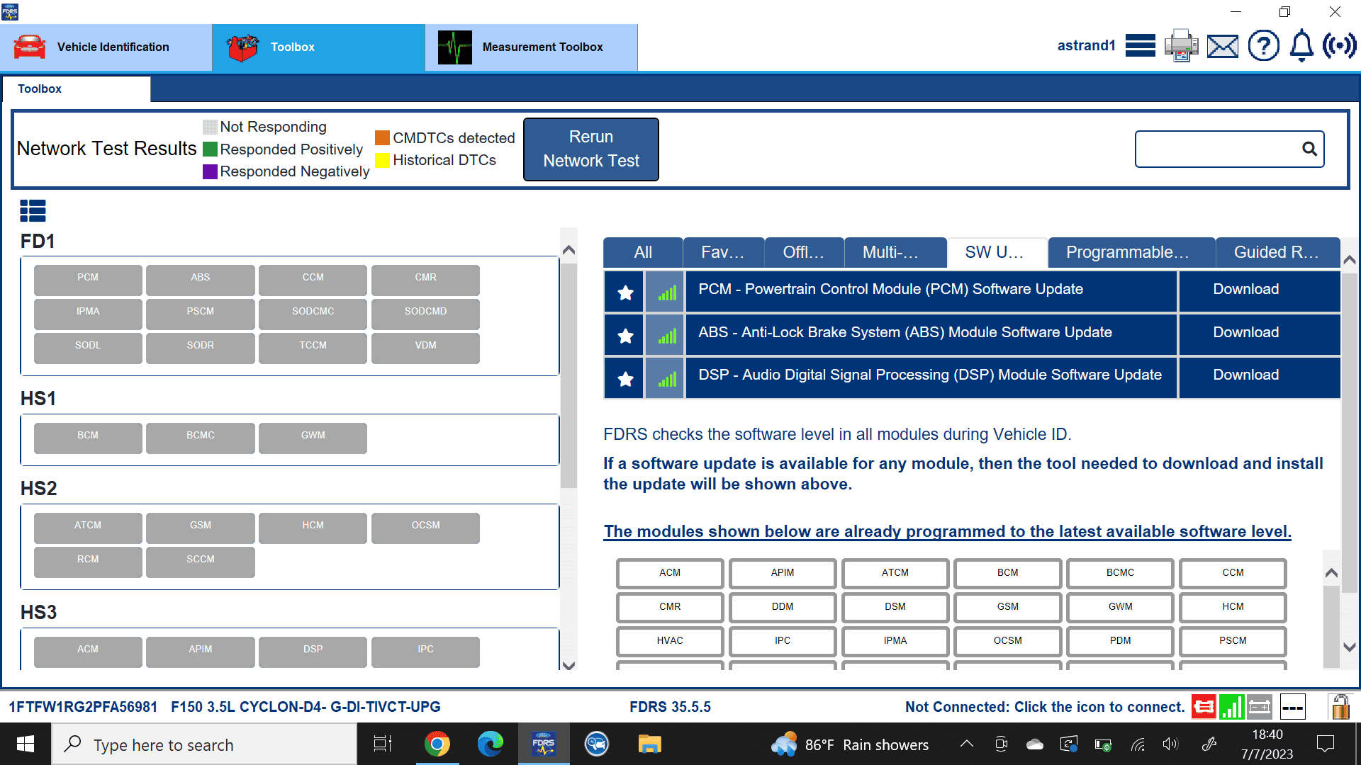

New to the forum, but have a 2023 Raptor on 4.2.2.2 that has a ton of Sync issues when the auto lights turn on, parking sensors turn on, cameras turn on etc. What happens is the audio will glitch and freeze, the screen may completely lock up, phone call audio may drop, and so on. When the system totally freezes, it’ll reboot after a couple minutes and will say “Raptor Saved”.
With all those issues, it sometimes makes it to where trying to listen to music or use the parking sensors/cameras just isn’t worth it.
Can someone check on VIN 1FTFW1RG2PFA56981
Thanks!
