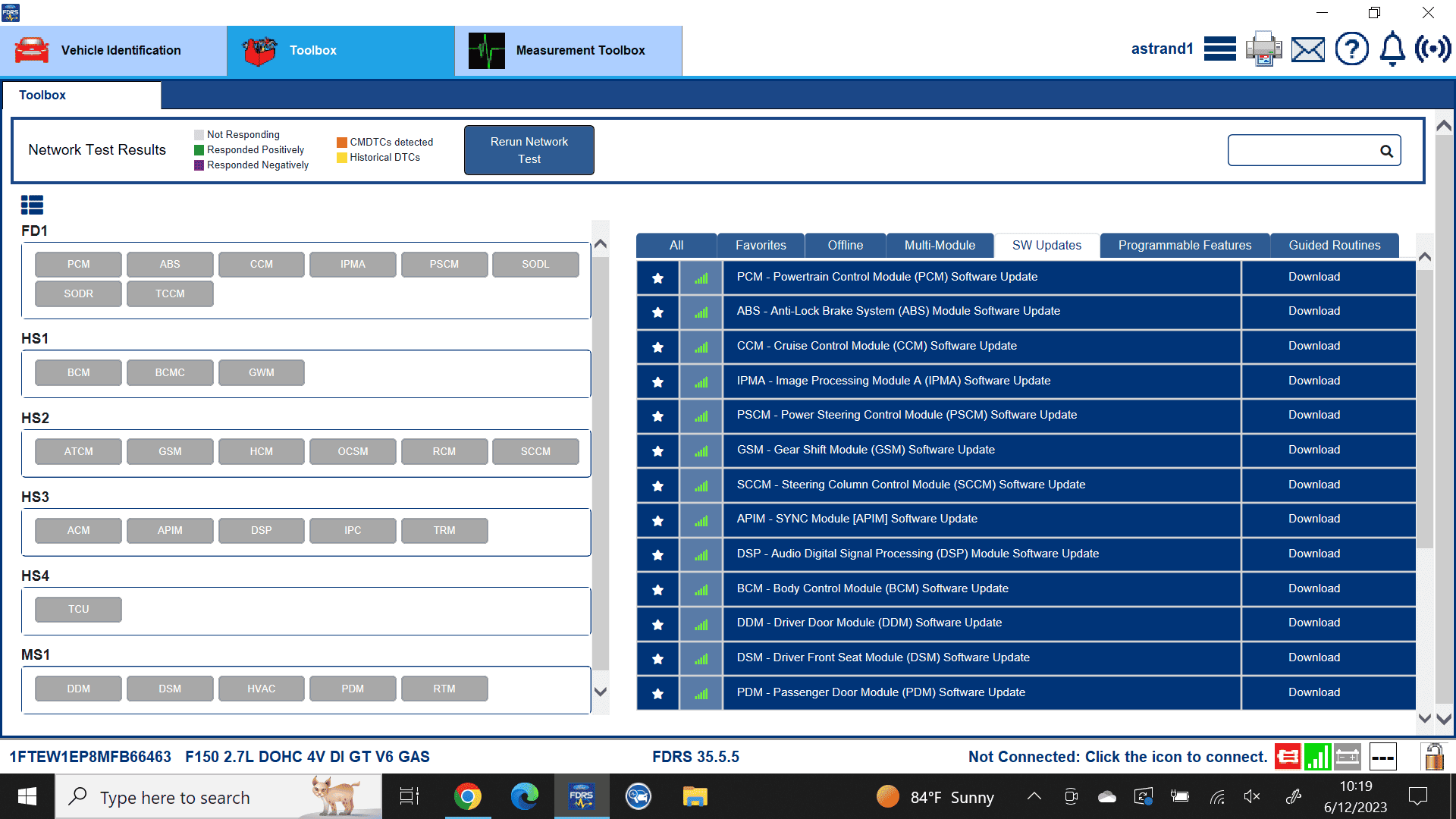

I'd love OTA look up for my truck. Thank you in adance!
1FTEW1EP8MFB66463

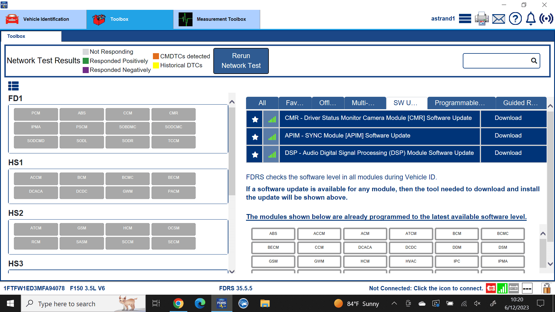

Can I please get a VIN check to see if I have anything pending in FDRS, Was getting regular OTA updates but now seem to be missing what I see everyone else getting
2021 Limited
Thank You!
1FTEW1EP8MFB66463
Your truck has never recorded an OTA and you are on Sync 20301 which is software from 2020 known to break the OTA process. Without the dealership's or your intervention, your truck will never get an update. Your APIM needs to be manually updated to get your truck out of its current state.
2021 Limited
Thank You!
1FTFW1ED3MFA94078
That APIM update showing is 4.2.2. It has been sent to your truck via OTA six different times between 4/21 and 5/27 but it has failed to install every time. There is something about that update that your truck doesn't agree with.
