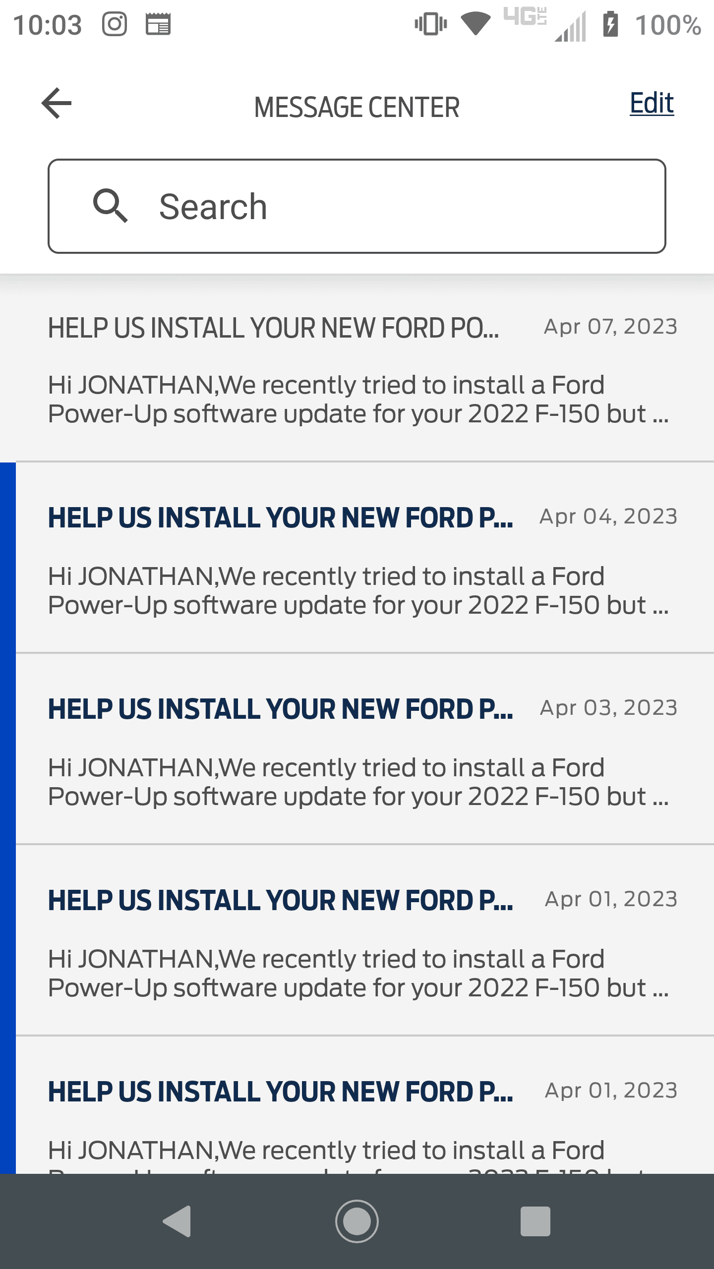

@rugedraw would you mind taking a look at mine again? 1FTFW1E86NFA69468
On 3/21, I got 4.2.1 without issue. Starting 3/23, 22-PU1010-MIL-QL has attempted to install ~4 times per week (each of my scheduled times), but fails. In the AM when I start the truck, I get a message that a pending update needs to install but requires vehicle down time. So I shut it off, lock it, come back ~30 min later and head to work. Next scheduled day, same thing happens. Ford pass keeps giving me a message to "help install". Tonight at midnight is one of my scheduled update times. I've had the truck hooked up to the battery tender since early afternoon, so hopefully that helps. Any idea what to do to get this one to go through? Thanks!
