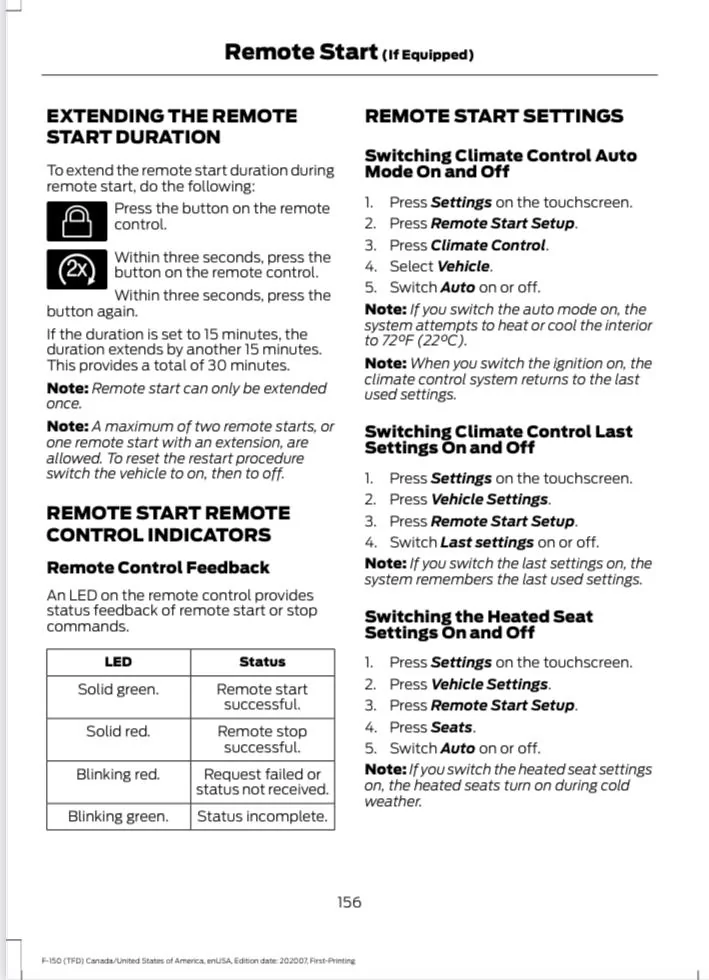

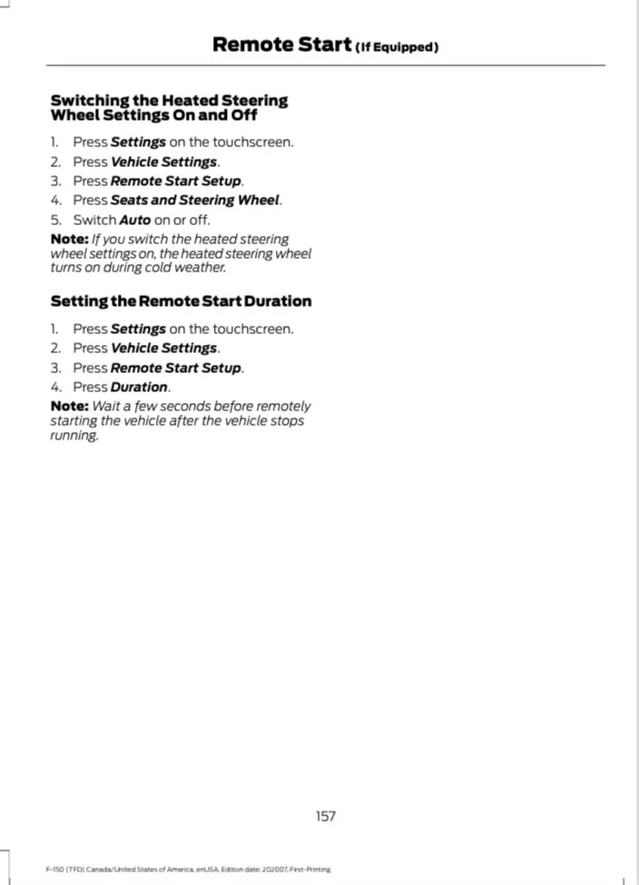

That's how I have it set up. I guess it may not defrost unless you have it set up that way since its not saying anything. But still doesn't explain the heated seat not working.
Appreciate you digging that up.
