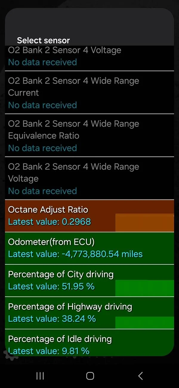

The OAR is 'red' in my Torque App. Pretty sure this is the issue. Thoughts?
