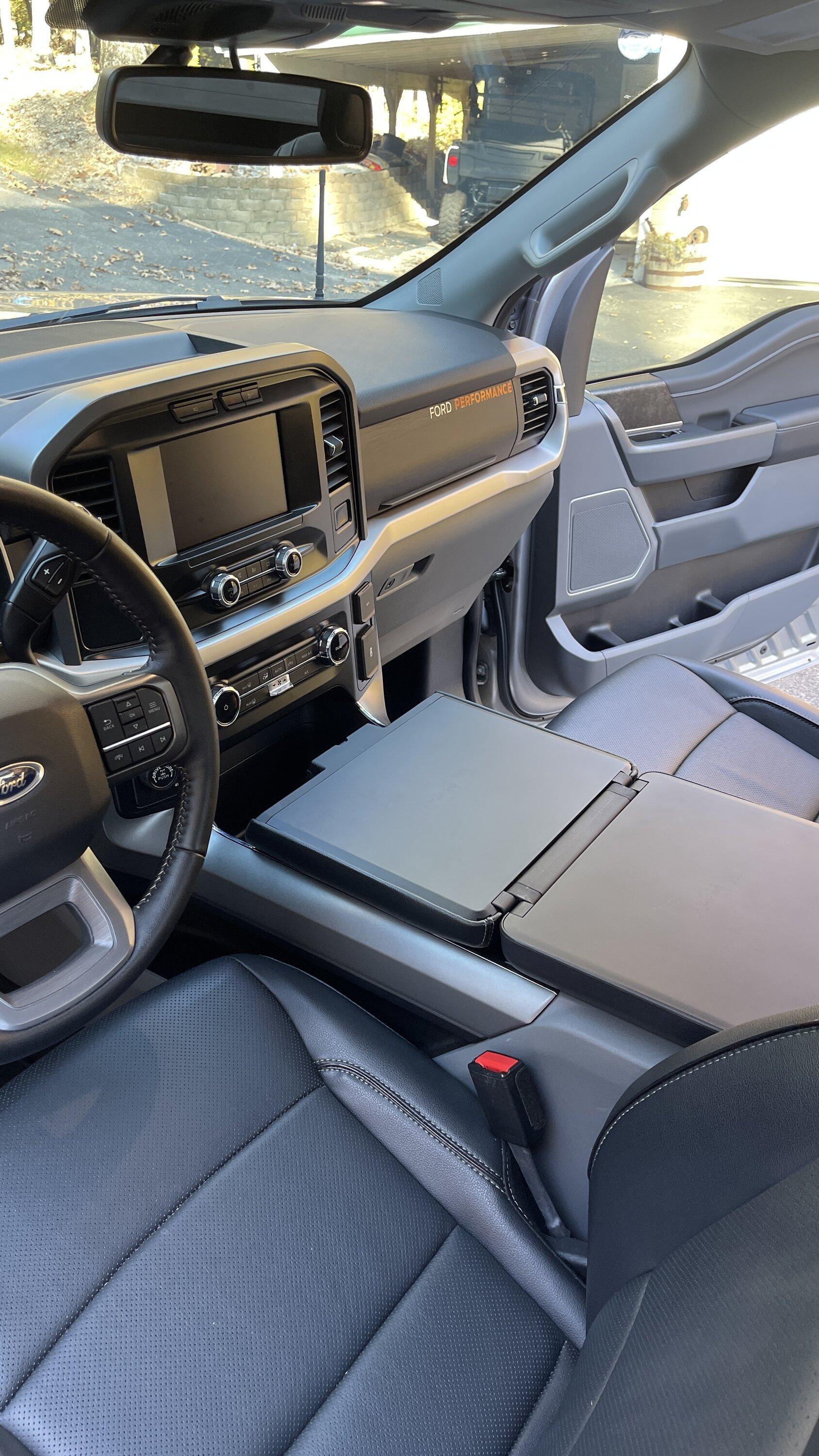

Hello! 2022 XL with cloth 40/20/40 seat setup. I'm pretty sure I've seen trucks with a center console in a regular cab so I'm assuming there must be a swap available, but obviously then you end up with a 2 seater instead of 3. Are there any seat swaps or console upgrades for the 40/20/40 setup? Thanks!

Ok cool, so you just need to get a center console assembly that doesn't have the shifter and then the HVAC trim panel for a truck with the 8" screen instead of the 12" screen, as well as the bracket bolts. Trying to decide if I'm alright with losing the jump seat or if I'd rather retain it. Looking like most guys are just re-covering the stock seats. Wasn't sure if there was anyone doing seat swaps yet with different seats or something.

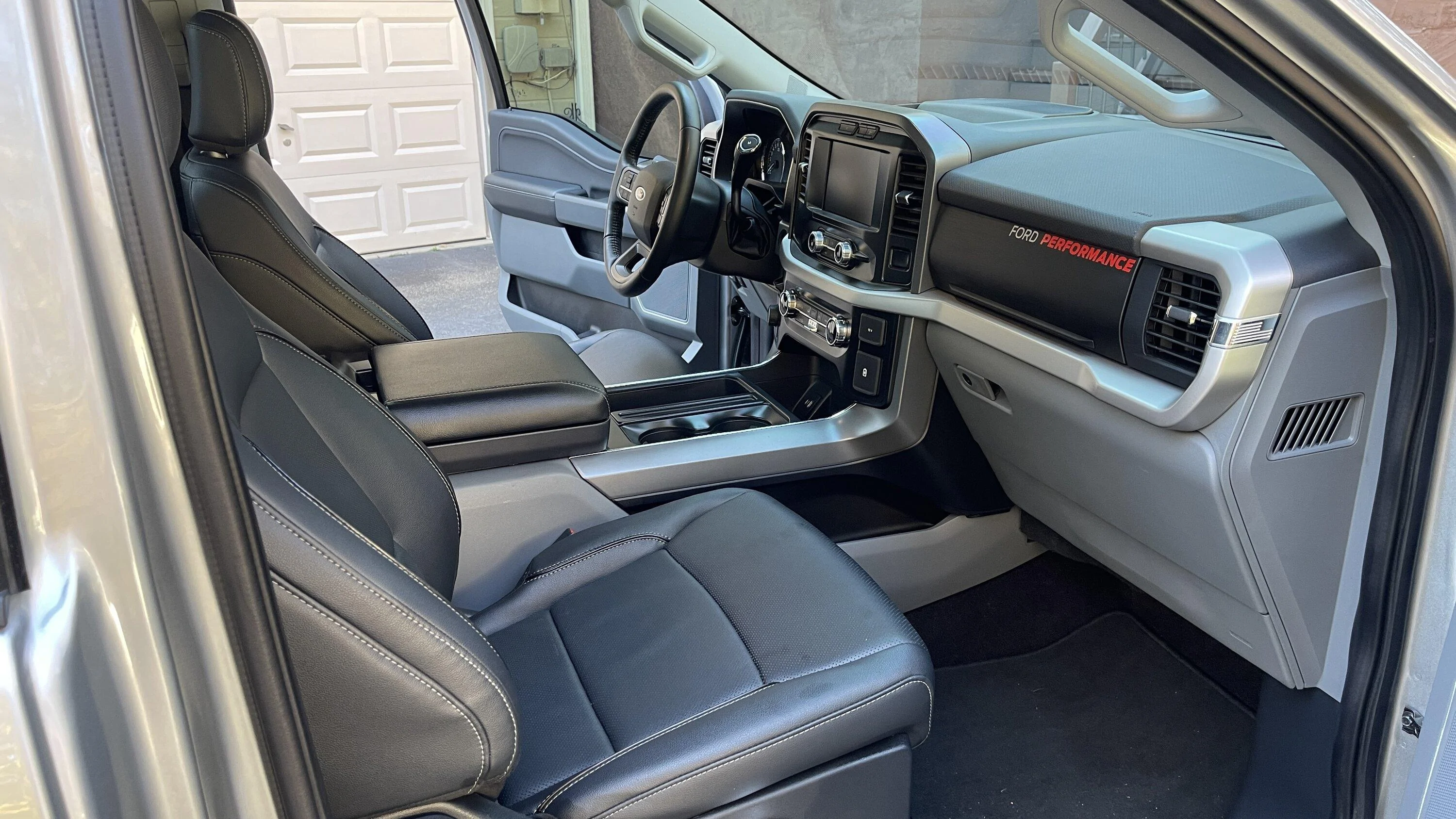

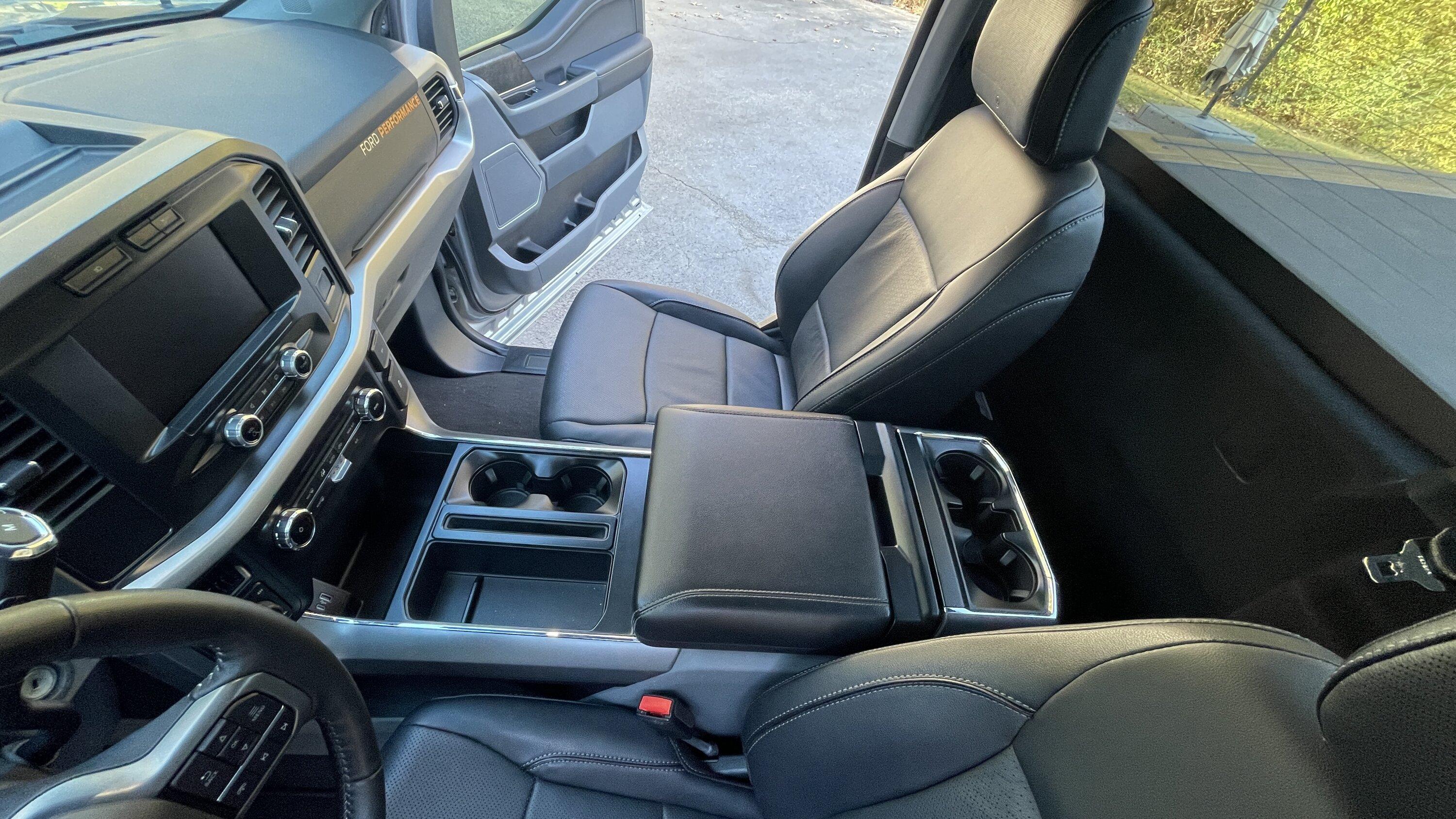

The console bolts in the same place as the jump seat. My bolts worked and used the bracket that was there when I took out the jump seat. You can use console with the shifter in it if you like you will need the wiring harness that goes to the steering column and upper and lower steering column trim so when you remove the column shift. I redid the seats my self , with those brand new takeoffs from eBay. It took me shopping for about 6 months to find a console that wasn’t priced through the roof.

On my 24 I just unbolted the seat belt buckle from the jump seat and plugged it back in. Zip tied it in place under the console so it doesn’t move/rattle. Probably easiest way if you’re trying to avoid forscan.
I also purchased a console with the stowaway shifter, I just ordered the tray from Ford parts and swapped it over. The tray bolts in the same as the shifter assembly, I’d have to dig up the part number for it though.
