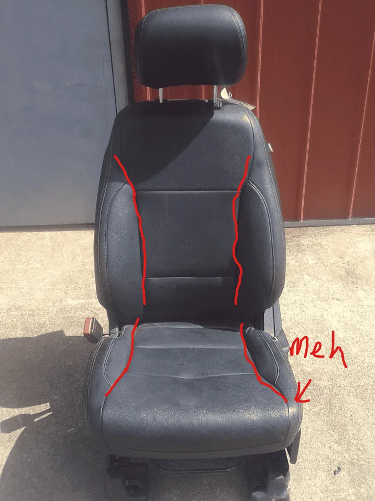

They're some of the most significant difference. They're π shaped in their 'valleys' (platinum / KR) at the front portion of the seat, The XLT and Lariats are more H / Y hybrid, the raptors are even more H than Y than the latter, the plat / KR are much different. The XLT / Lariat are very close -- same shape, just different retention methods in one area. They're close enough to put lariat leather on the XLT foam though. I'd have to see tremor seats to see which one they're close to, I think one I was looking at appeared to use raptor cushions on the bottom at least.
lariat - not fond of arrow, leg just wants to slip off of that area.

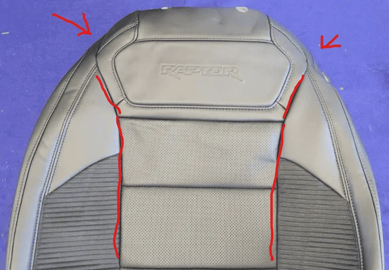

Raptor upper (sorta like lariat, tucks in tight at the top though)

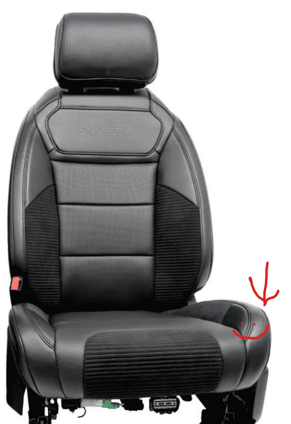

Where the raptor lower shines, nice full length side bolstering. This is a big difference to me where lariat / XLT don't have much frontal buckety bolster. Kinda like plat/KR, which I don't like. Makes the leg feel like it can just slide off.
