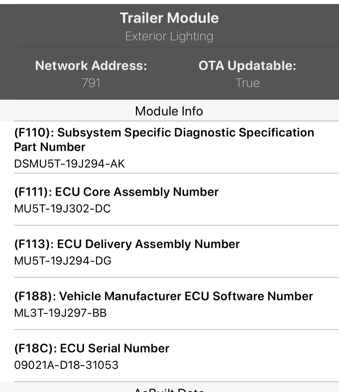

I’m trying to stay on top of this thread. Is the BB the correct software to fix the trailer module?

It appears to be. I have received the BB update and the problem has not appeared for me when towing. The Document from the NHTSA has a different version listed as the fix, but Ford says this BB version addresses the problem.
