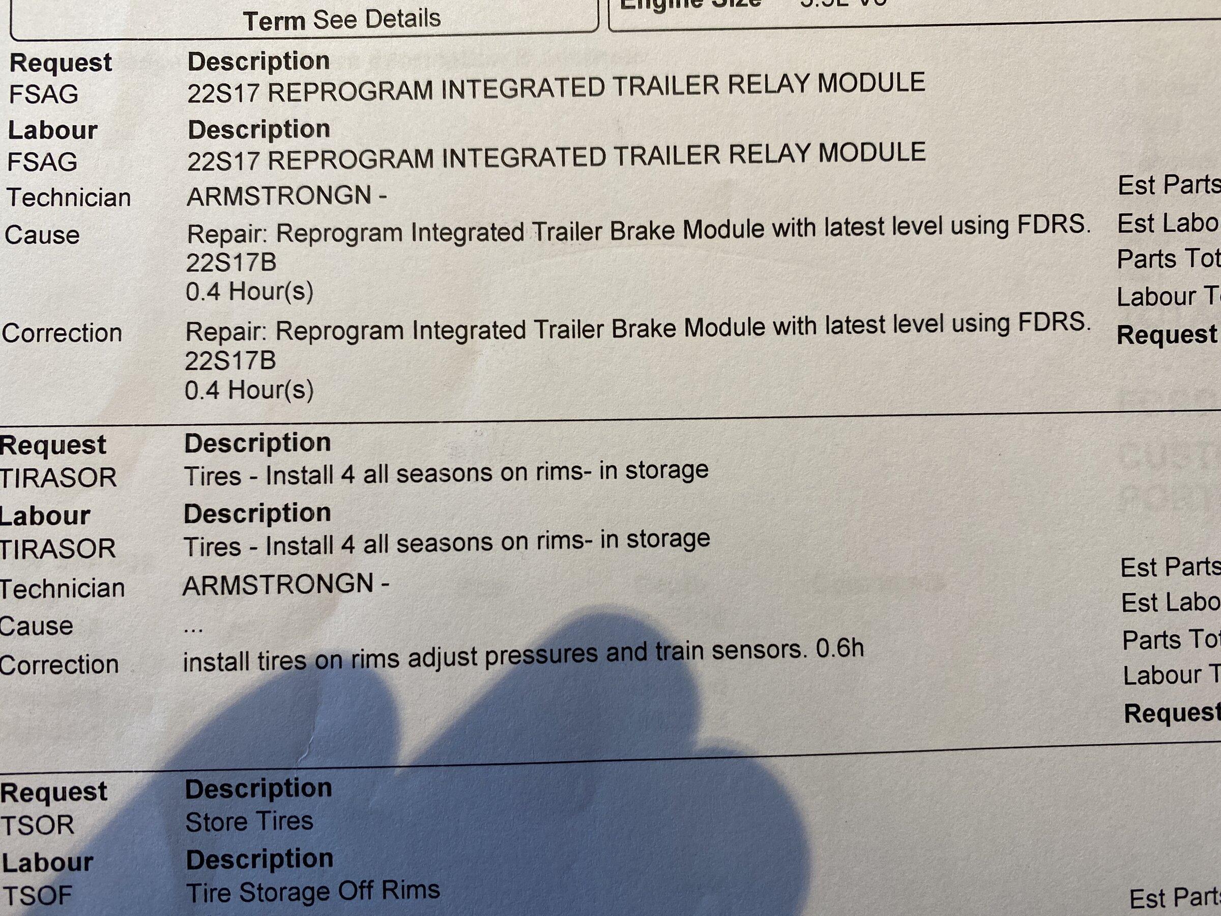

It‘s available. Had it done yesterday
That is probably the TRM update that came out in January that fixes a communication error, that gave a faulty DTC. It seems that many dealers see that in FDRS and think its the recall update, when it's not. Did the same thing to my neighbors F150 too.
Although, since your in Canada, maybe they have it available for your region.
Yeah….about that. You got the software that was released in February and not the fix for the recall.
Jesus dealers are fucking this up. @Ford Motor Company how are you ok with this? Why do people on the internet have more knowledge than your dealers??????

It's not in FDRS so dealerships won't have it... don't think this has been proven otherwise yet.
