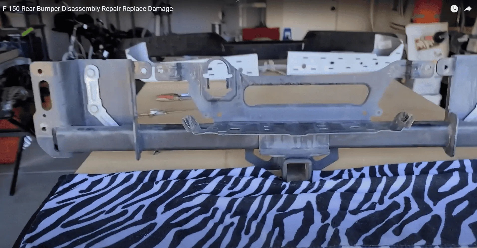

So I am watching this guy replacing his bumper cover on YT and it definitely looks like the lower area above the ball/in front of the license plate is a solid spot that you can step on, but TBH the long parts of the bumper extending from the center outward don't seem to me like a good/solid place to step on.

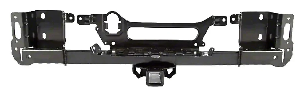

Not following. What does the bumper actually have to do with the hitch receiver? I don't think the hitch receiver is connected to the bumper or vice versa.
The hitch receiver is directly attached to and part of the actual bumper. Those chrome or body color caps are little more than decorative.
I suspect the question is about standing on the top of the caps and just based on how they feel when I am on them I don't thing anyone should worry about them supporting their weight.

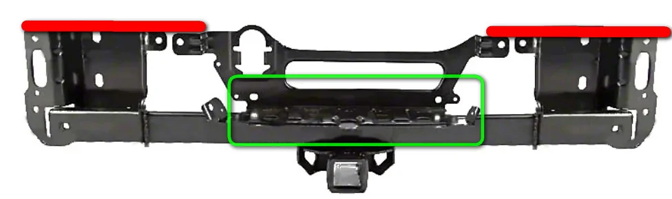

Right, so from your image above and the one from the YouTube that I posted above it is clear that the center part of the bumper right in front of the license plate is pretty sturdy and can hold weight (green part below).
But also looking at both pictures, I suspect that the raised sections (where the red lines are in the pic below) are not as strong and do not have a wide/deep support.
Yes, probable not as strong but still plenty so.
