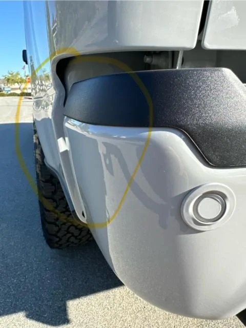

Anyone know if the rear bumper mounts allow for left/right alignment? Mine could use a good 1/4” shift toward the drivers side… see pics

Attached R&R procedure just FYI, I don't know if the holes are slotted to allow adjustment.

Thanks for the info! I hope to get under it today and take a look. :)

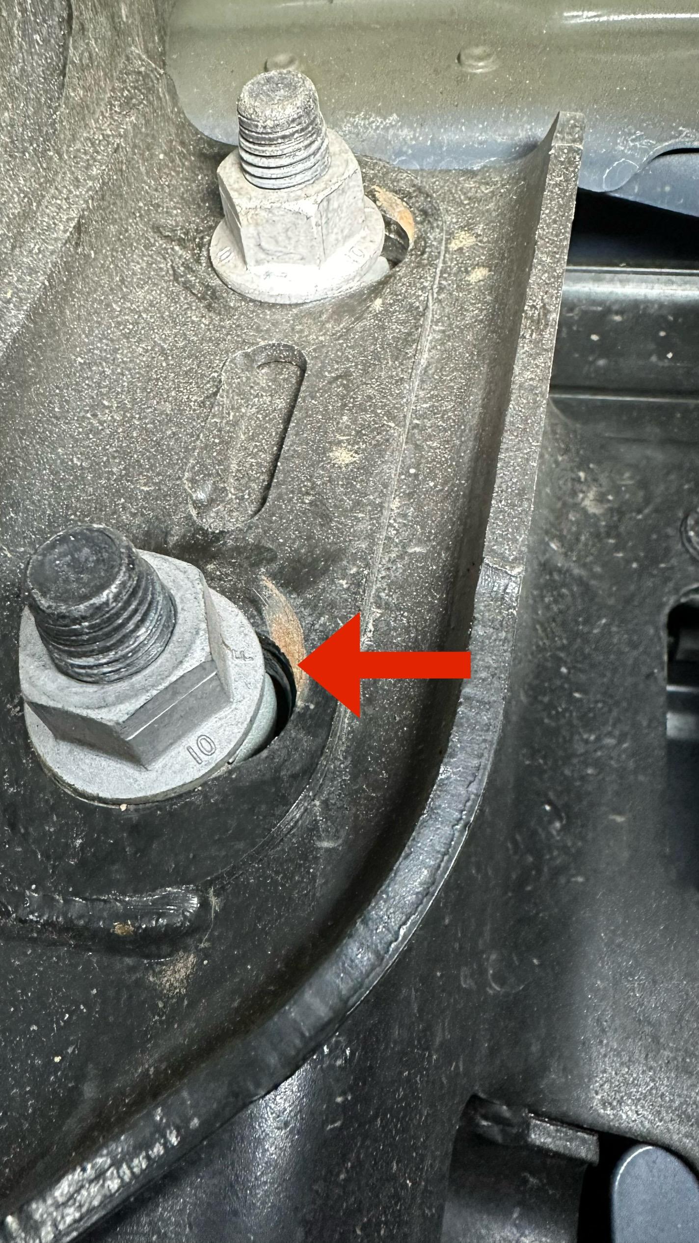

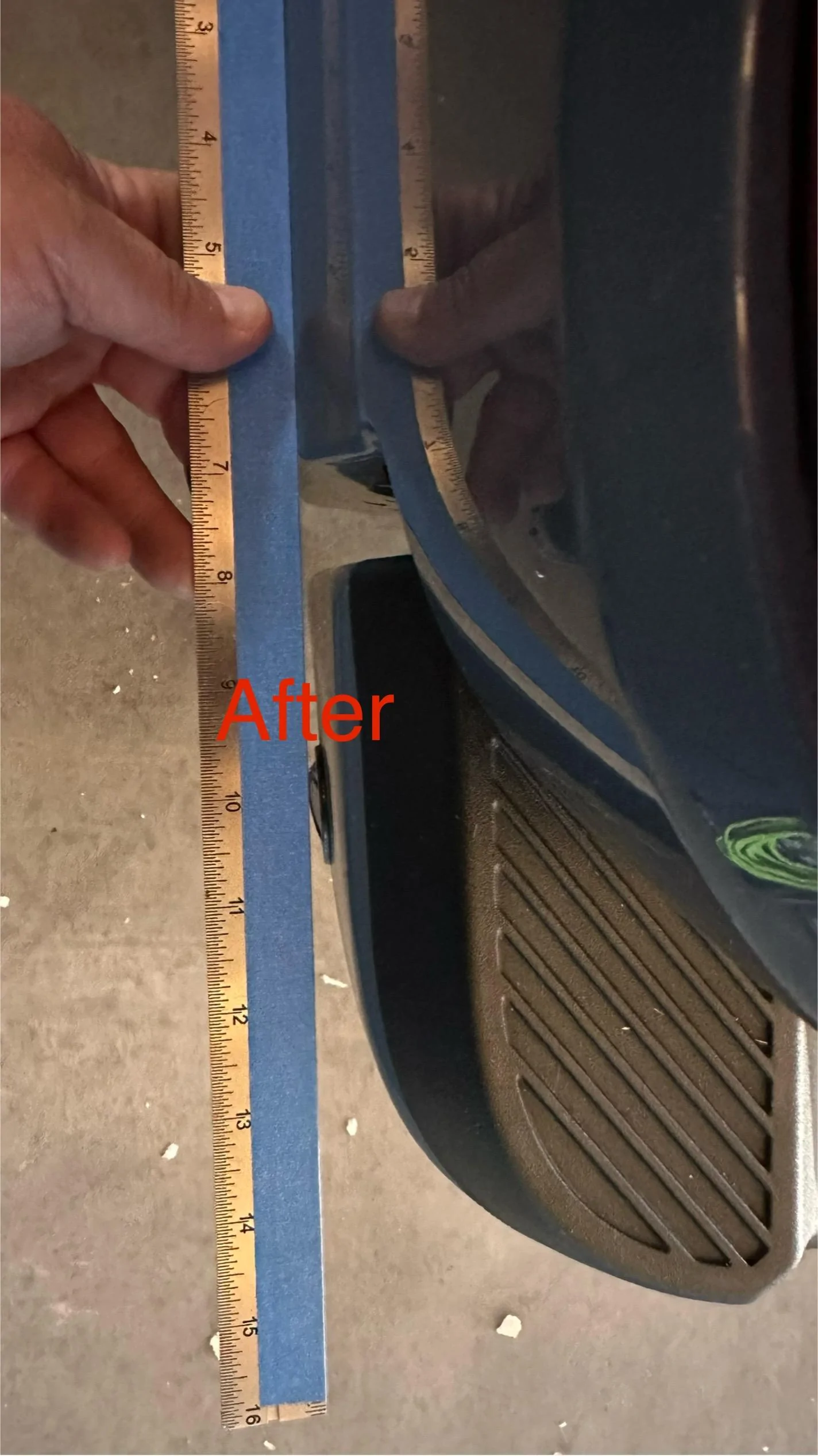

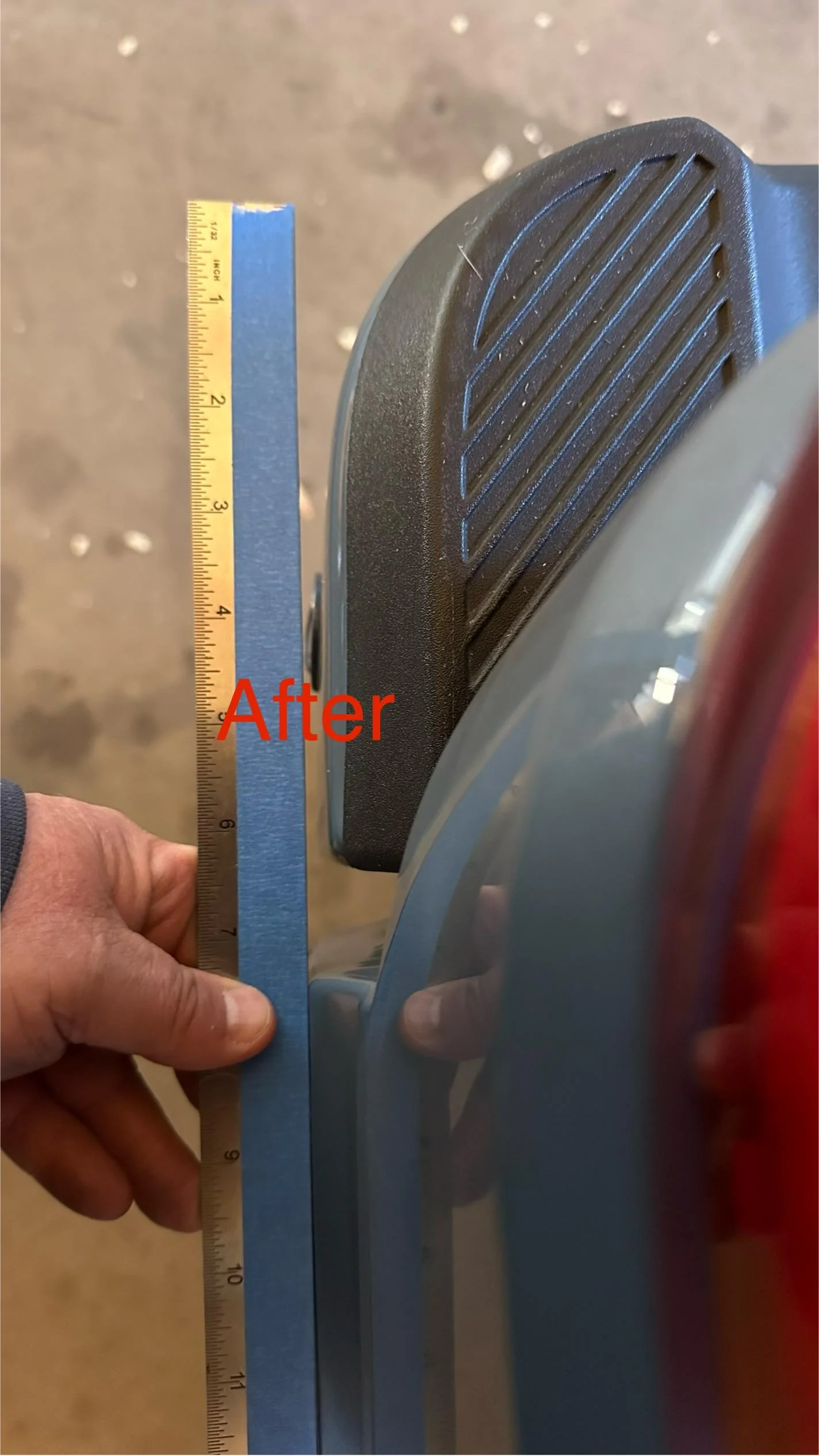

Sure enough the 6 mounting bolts allow for adjustment. Loosened, adjusted, and then retorqued. All good now.
