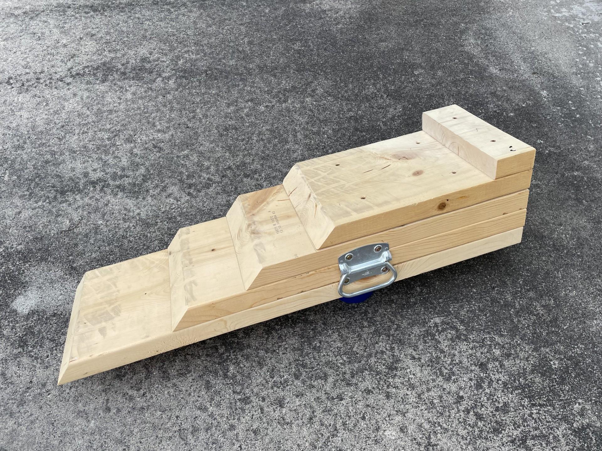

I like the plywood and the rubber leveler under the plywood if your driveway is uneven.
Also for ramps I just never trusted those old formed metal ones from the 70's and 80's. I always made my own out of wood. I also never felt good about the waffle style plastic ones.
For these I used 2x12's and it is solid. I needed to make it longer than I wanted due to having a lower cowled car I wanted to use it for too. This made it longer and heavier but it will not collapse on me for sure.
Make no mistake you will not be carrying these around unless you want to start singing Soprano but with some rubber Flex Seal spray paint sprayed on the bottom these things they will not move at all. I made them so they stand up against the wall too.
I made a set just like this and I feel much safer crawling around under the truck versus almost any other ramp or jack stand. I added a handle to mine by balancing them on a table edge, marking the balance point and attaching the handle...much easier to carry around (y)
You will not be crushed with these and you can use these on a hot blacktop and they will not leave indentations in the driveway.
You do need to eat your spinach before you carry these though.

Each one weighs 22 lbs, and even with my heart condition, I can EASILY carry one in each hand.....
