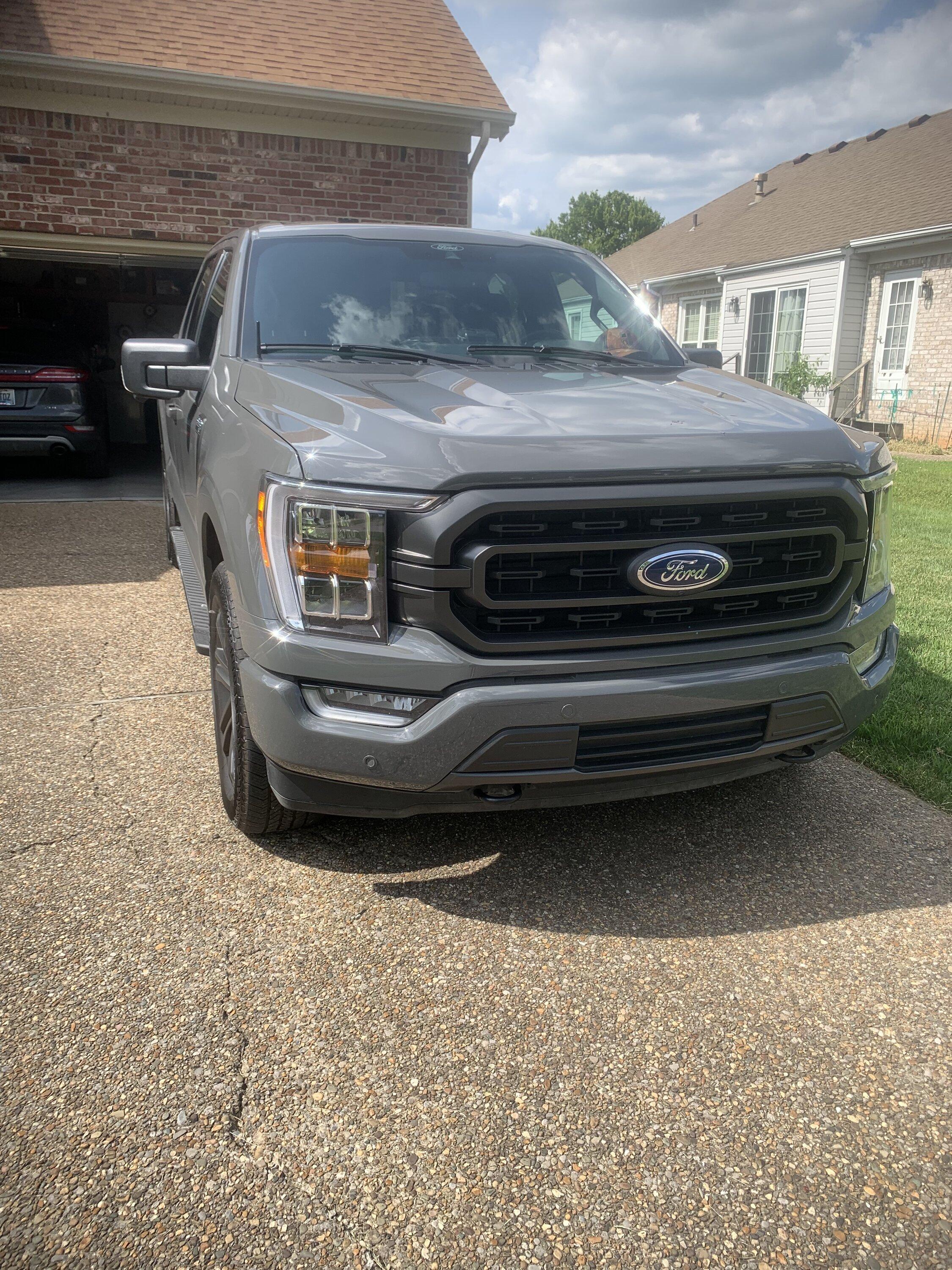

Hello everyone. All my previous vehicles were able to fit in my garage so putting them on stands to do maintenance was no issue. But my truck is too big to fit in the garage. My question is what would be a good way to use jackstands on a very rough driveway? Made of the concrete mixed with pebbles.
Picture attached

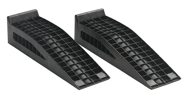

When working on dirt or gravel I used jack stands that had a sold metal plate between the 3 legs. Now I use a pair of truck ramps that support 12,000 lbs in total. They cost me $50 in 2013.

3/4 plywood works fine on my asphalt driveway. Keeps the feet from sinking through the asphalt. Also use this when working on dirt, gravel or concrete driveways. For changing oil I usually use ramps like Calson showed. Driveway is on a slope, so I back truck up slope, place ramps then pull forward onto the ramps, which actually puts the truck level, so makes checking the oil easier.
