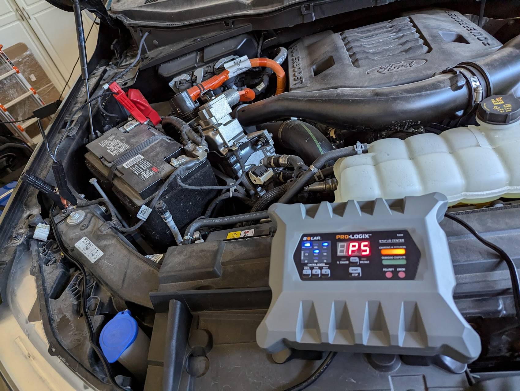

I got my car on the charger in "Power supply mode". The thing automatically chose AGM as the battery type and i saw AGM written on the battery, so that felt like the right automatic selection.
The ground for the black cable is nicely located.
