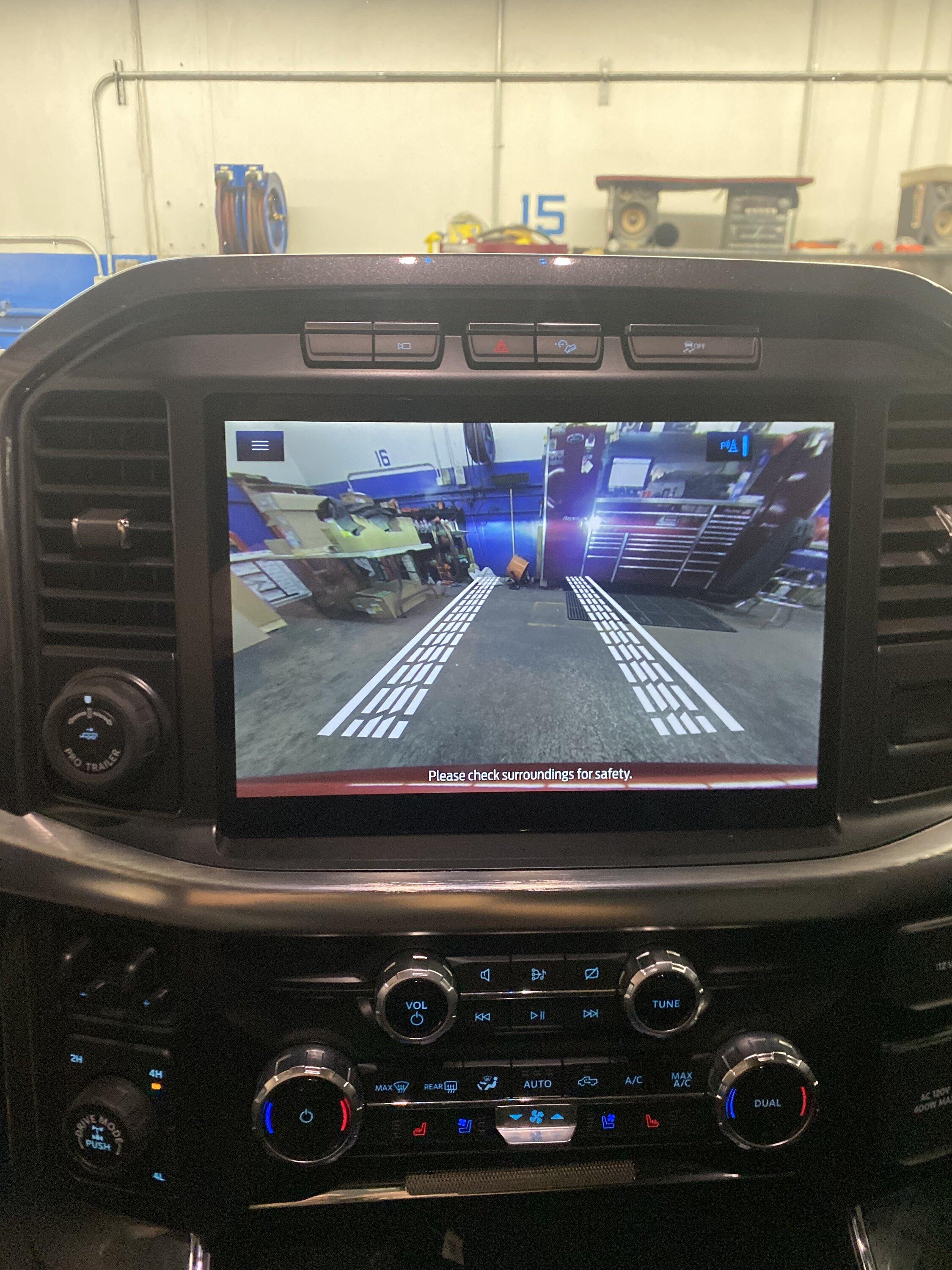

Hey guys. New here. Not new to the game. I’ve looked thru the threads and I saw SOME info, but what I’m running into is new. So I have a ‘22 Lariat 501A and I tried to put the front camera view for MUD/RUT on my truck. I did it a couple weeks ago with FORScan, but then I did a shit ton of updates when I was doing my axle bolt recall and now it’s gone. OOPS!! Well, I tried to put it back in under the 706-02-02 but NOW I’m setting a PRE-COLLISION fault with a U2101 Incompatible Configuration. Does anyone have any idea what ELSE I need to change now to add this feature?? As much programming as I do, I’m not THAT tech savvy to isolate all that data.
TIA!!
