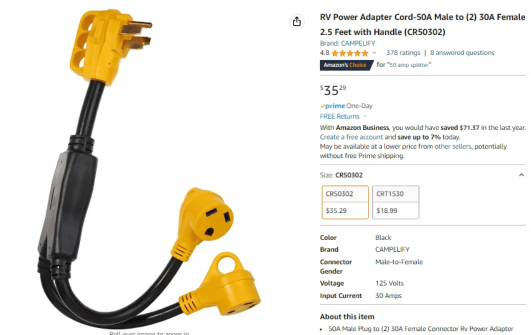

You could maybe use combination of these cables to get two 30amp circuits if you really need to split your trailer load.
However, maybe you just need to install a soft start and then your trailer wouldn't have as much inrush.

You guys are so right. Thanks all. So the trailer plug only has 1 hot 1 neutral and 1 ground. Twist lock has 2 hot 1 neutral and a ground. So I'm going to make a plug that splits the hots. One will go directly into the AC and the other phase will do all the trailer plugs. Got some wiring to do this week! Thanks all.
Dawg had some great suggestions. The trailer 30A service panel is like our home service panels. If you add up the amperage ratings of all the breakers it exceeds 30A because rarely if ever do we have everything on at once and drawing maximum current. Your AC compressor and microwave oven are both high demand items. The AC kicking on while you're microwaving is reasonably rare but it happens. MicroAir makes a soft start device that greatly reduces start up current demand for AC compressors. You'll see that start up demand called inrush current or locked rotor current. It spikes very high momentarily to get the rotor electrically unstuck, then drops significantly while running.
