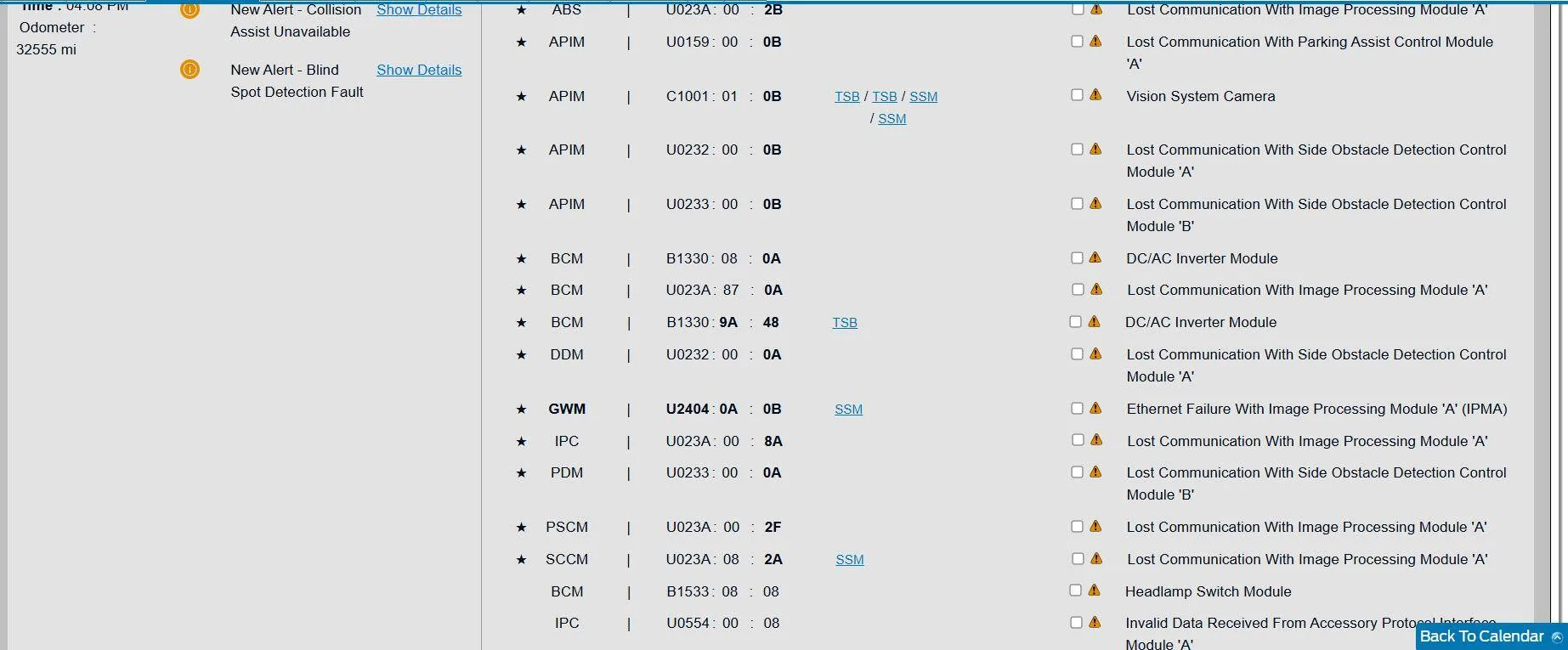

Hey everyone, new to the site and I've started getting the above errors about a week ago all at once while driving, I can turn off the truck and I can go a few days and everything is fine and then all of a sudden while driving these errors pop up again, anyone else encountered this issue?

Got your message. Truck is reporting several faults.....hard to diagnose remotely. Some of these are old stored codes, but a lot of these are active faults in the ABS, APIM, GWM, BCM and others. Dealer would need to plug in and run some pin-point tests to get to the root of the issue.
Great, thanks for the info, I really appreciate it!
